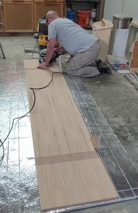

Step 2: Make Kerf Cuts
Set your circular saw depth to cut through all but the veneer layer and most of one inner layer. I highly recommend running a couple test pieces before doing it on any valuable pieces of wood. We used two straight edges and started the kerf cuts about 12 inches from the end of the boards. Then, we moved each kerf cut using some scrap 1/4 inch dowels. A total of 12 kerf cuts were made on each side. 10 kerf cuts will likely make the 90 degree angle, but we went 12 just to give a little flexibility.

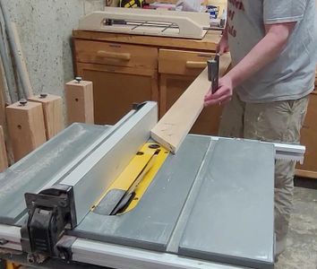

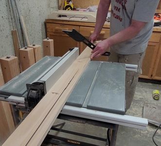

Step 3: Cut Equal Widths
Cut the whole unit (after kerf cuts) down the middle. Since we always have a little movement when trying to cut an 8ft length, we then stacked both pieces on top of each other and cut them together, the exact same width, roughly 19 inches.

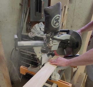

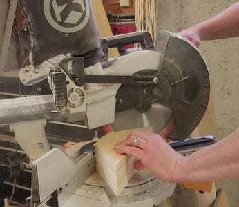

Step 4: Cut Corner Supports
We used the miter saw to trim off 4 total pieces, 10 inches long, with 45 degree cuts on each end.

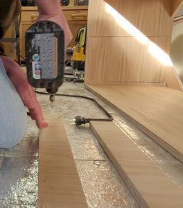

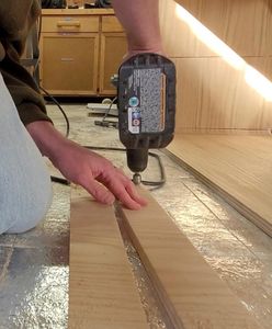

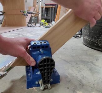

Step 5: Add Pocket Holes
Add 4 pocket hold screws at the 45 degree cut edge as shown in the pictures.

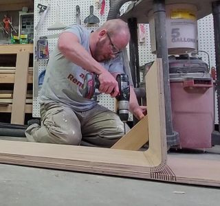

Step 6: Trim (if Necessary) and Install Corner Brackets
So, we did this a little backwards, but it still worked. We installed the corner brackets and set up the cabinet. We found that overall, the cabinet was about 31 inches tall and way too big for our liking. So we unscrewed the corner brackets and cut off 3-4 inches on each end. Ultimately, the height ended up around 24 inches, which is perfect.

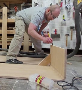

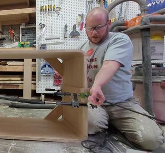

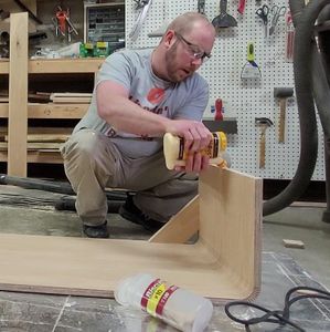

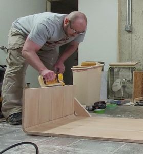

Step 7: Add Biscuits and Join
We cut three biscuit slots using our Ryobi Biscuit Joiner, then glued the two cabinet pieces together. We used some clamps and spare wood (with painters tape on it) to hold the pieces in place as the glue dried. We also put a couple 40 pound weights on it overnight.

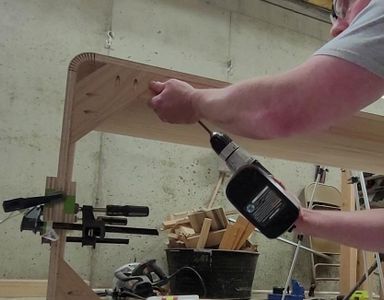

Step 9: Reinforce Glued Joint
So, I am always afraid of glued edges, especially considering how pourus the plywood edge is, but I didn't want to add more pocket screws. So, instead, I used some of the remaining pieces from Step 6, cut them to size and countersunk a few screws at that joint. I figure if I decide later I want to add a middle shelf, I can use these braces to support the shelf.
Step 10: Add Front Corner Braces and Bottom Support
I added some smaller 8inch corner braces in the front (recessed 3 inches in case I add doors with hinges later). Then I used the last roughly 6ft piece to create a support for the bottom/back of the cabinet, cutting in the 45 degree cuts and pocket holes.
