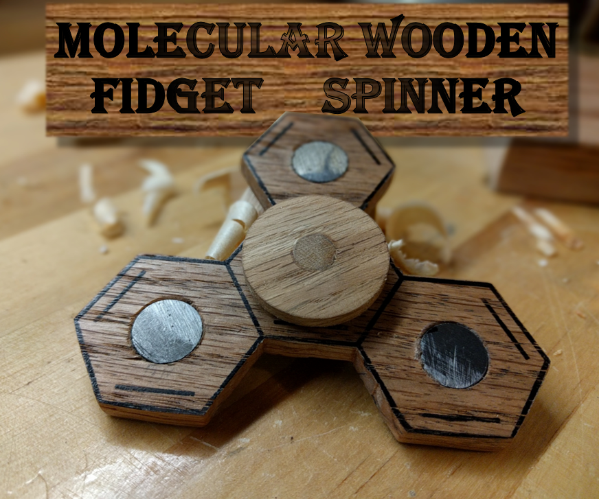

I also have two young sons who both are mildly obsessed with fidget spinners (who isn't nowadays?). So, I decided to try my hand at making an "organic electronics" inspired spinner! I ended up making two different wooden spinners: one based on the fundamental organic molecule of Benzene (which is a hexagon of carbon atoms) and another based on a molecule of Triphenylene. I made these in two very different ways, so I decided to split them into separate Instructables. In this one, I'll show you how to make the one based on Benzene (https://en.wikipedia.org/wiki/Benzene).

Step 2: Draw It Out and Cut
You'll need to cut out two regular hexagons with a distance between two opposites sides of 3.5". I drew the shape using a straight-edge and a compass, but it would have been easier to have transferred the template from Step 4 and would shorten the number of steps.
Start out by getting your wood pieces with a width of 3.5". Since I used the 24" x 48" plywood, I just cut a strip of width 3.5". Draw a 2" radius circle. This is a close approximation of the size of the transcribed hexagon. Draw a straight line down the length halfway the width of the board (1.75" from each edge). With your compass still set to 2", pivot it on the intersection of the circle and the straight line and mark where a new circle would intersect the original circle. Repeat this by pivoting on one of the new intersections until there are 6 intersections that transcribes the hexagon. Connect the dots to define the hexagon. The top and bottom of the board will already be two of the sides.
I found it easiest to set my miter saw to 30 degrees and cutting the edges out with that. Otherwise, you can use your favorite cutting method, such as scroll saw, band saw, hacksaw, coping saw, well-placed karate chops, etc.
Do this again for the 2nd piece. Draw a 1.5" radius circle centered on the hexagon along with diagonal lines that join opposite corners. We'll use the intersection of the diagonals and the new circle to drill holes in the next step.
Step 3: Add Weights
You'll see in the pictures that I cut 3/4" holes into the corners of the hexagons. These are to hold pennies. You can use any other coins if you want, but just use the appropriate spade bit. I used the spade bit so I could drill partially down and keep the bottom of the hole square (you could use a forstner bit instead). However, this still requires the point of the bit to make a hole all the way through, so I clean that up afterward by drilling a clean 1/4" hole and plugging it with a 1/4" dowel that is glued in. I drilled the pilot hole for the spade bit at a radius of 1.5" from the center (although, you can put them wherever you wish) and in line with the corners.
Apply glue to the interior of both hexagons, but don't bother putting any in the coin holes. Apply enough glue to completely cover the mating surfaces (but don't overdo it). Remember to put your pennies in the holes. I made the holes deep enough to put one penny in each side, you'll just stack the two on top of each other as you assemble it all. After the pieces are in place, add clamping pressure. After it's dried, cut some small plugs from a wood dowel and glue them into the holes above the pennies. It's OK if the plugs are a little long since we'll just sand it down anyway. Let the glue dry and sand everything down to smooth.

Step 5: Drill Out the Bearing Hole
The template includes a convenient crosshair to line up the central hole for the bearing.
I used a 7/8" drill bit for the central bearing hole since I used a 608 bearing. The bearing is actually 22 mm while 7/8" converts to just over at 22.225 mm. The whole will be a little oversized, but I just wrapped the bearing in a layer of electrical tape (I'll go over that later). You could instead use a 13/16" drill and then enlarge the hole with a small drum sander or round file. I used a spade bit and the hole turned out fine. I'm sure a forstner bit would be somewhat cleaner. I'd wait until later to put the bearing in.
Step 6: Make the Finger Pads
I used a 1-1/4" hole saw to cut out a couple discs of wood. I decided to add a little fender to the discs to keep them separated from the bearing and only touch the inner race. This could be done in a lathe. Even though I don't have one, it didn't stop me from using other tools in ways they weren't intended. So, I clamped one at a time on a machine screw with a few nuts to tighten down on it. This was chucked into my drill press. I clamped a coping saw upside down in my drill press vise. With the press spinning, I slowly brought it down on the eagerly awaiting saw blade and used it to "face" the disc and leave the little ledge. I used a file to smooth it out a little bit and better define the ledge.
I took the two discs and enlarged their holes with a 5/16" bit, which corresponds with the wood dowel that is just a little smaller than the inner diameter of the bearing. I pressed the dowel into the discs and dry-fit the bearing to make a sandwich of them. This let me know where to cut the dowel off. After marking the cutoff location and dismantling the spinner, I cut the dowel to size and glued it to one of the discs. If you're like me, you might shy away from commitment (don't tell my wife!), so the spinner works fine by leaving the other side as just press-fitted onto the dowel. You could also counter-sink one of the pads and drill a pilot hole in the dowel for a small screw to hold it together (in my experience, this screw starts to work itself loose, so I'd go with just press fitting). You can then remove the finger pads and clean out or replace the bearing when needed.
Step 7: Putting It All Together and Cleaning It Up
As I mentioned before, the 608 bearing is too small to make a tight, press-fit into the 7/8" hole. So, I did one layer of electrical tape to fill in the gap. If you line up one edge of the tape with the edge of the bearing but let the other side overhang, you can use that to help pull the bearing through the hole and you should only have to trim one side when ready. You should be careful to not let the tape touch the ball bearings or the races so it doesn't leave a sticky residue that will slow down the bearing.
When in position, you can trim off the excess tape from the bearing. The dowel for the finger pads will need a small amount of tape as well. I found that scotch tape is a little thinner and gave me more precision in adding thickness than the electrical tape. In the end, either will work fine. Press the pads together. The spinner is now functionally complete. I sanded down the dowel to make it flush with the pad. You should protect the wood. I used some wood wax, but you could also use a couple coats of spray lacquer to protect the spinner part. If you do this, you'll want to remove the bearing or tape it off to keep the lacquer from gumming up the bearing. Have fun fidgeting and be sure to look up some of the science behind Organic Electronics!
