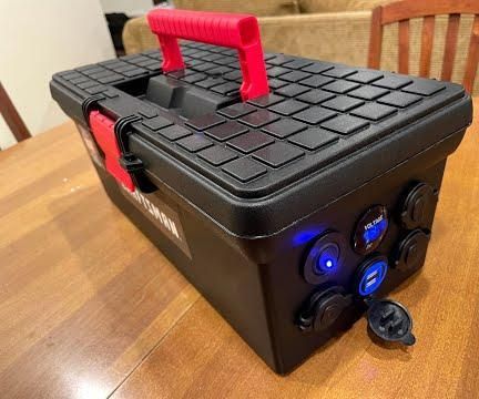

Step 8: Add a Socket Adapter
Add a car socket adapter – in the parts list we link to a 3 port socket connector that should be suitable for 80% of users. The 18 AWG wires limit the total wattage to about 150 watts, which is fine for most people and has been plenty for me, but strong riders may want to build something with 12 AWG wire using separate sockets and a project box. To hook up the 3 port socket adapter, just solder on the XT60 connector to the matching wire colors, add some heat shrink tubing (put the tubing on before soldering, far up the wire so it doesn’t get hot) and plug in!

Get charging! If you just plug in car charger adapters, most will start charging at around 9v input, and the good quality chargers (like the Anker models referenced in optional parts) will handle up to 24v input without a problem. If you only charge with these type chargers, you can pretty much pedal to your heart’s content if you followed the design as I've outlined, and not worry about limiting voltage. Need an easy ride, just plug in a cell phone or two. To add more resistance, add more car adapters and devices. I’ve tested this generating up to almost 400 watts. It can go higher, but that’s nearing the limit of the 50 year old pushing the pedals (me!). The motor itself is capable of up to 1820 watts. Can you push 300 watts? Anybody up for 1000 watts? Want a challenge? Brew some coffee!
If you want to power something that plugs into a wall outlet using an inverter, or have a desire to charge a 12v battery, then you’ll need to be mindful of the voltage you are generating, and keep it to under 14.7 volts or so.
