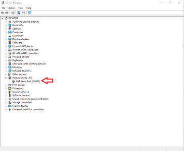

  • Find your COM PORT number in the Device Manager panel
  • Press Windows + X and click on Device Manager
  • Look for the Ports tab and expand it
  • Remember the number of the USB Serial Port (COM_)

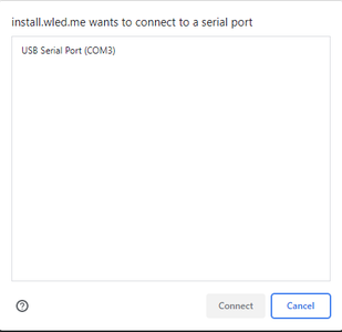

  • Go to the website: https://install.wled.me/ (this installation webpage will only work on Chrome)
  • Click on Install.
  • Select your USB Serial Port (COM_) and click Connect. Wait for couple of minutes until the installation is complete and the ESP8266 is now a WLED controller.

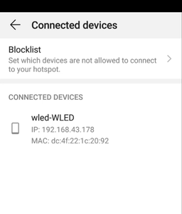

Once we go to the address http//4.3.2.1 we can enter our WiFi network, I entered the WiFi Hotspot network of my smartphone, that way the WLED controller will connect to my smartphone every time I need to use it outside, you can connect it to your WiFi Home Network if you wanna use it only indoors.
  • I enter the WiFi network name: TEST12
  • and enter the password: test1234
This same configuration is in my smartphone hotspot configuration menu.

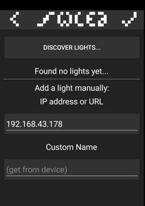

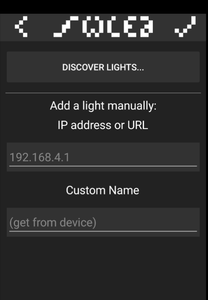

Once you start the WLED controller will connect to the smartphone, you can enter to the IP address that the smartphone gives to the WLED controller or you can download the WLED app for easy configuration.
WLED playstore link: https://play.google.com/store/apps/details?id=com.aircoookie.WLED
In the app you can click on discover lights or enter the same IP address you entered before.

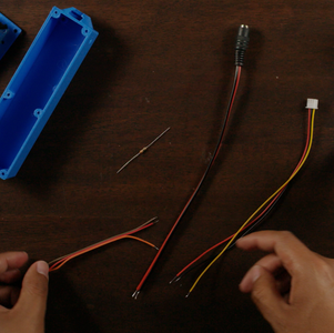

Step 3: Hardware Connections
You can connect your WLED and buttons inputs and outputs following the main diagram.

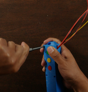

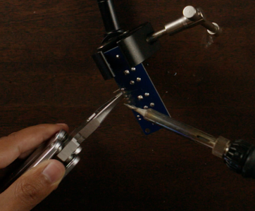

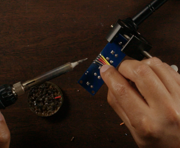

I desoldered the pins of the buttons module to make the module easy to fit inside the 3d printed case, you can also bend them or cut them.
Solder some jumper wires to connect the buttons to the WLED controller (ESP8266).
Solder together the power connections for the WLED controller (ESP8266) and the LED strip.
And connect everything together as the main diagram.

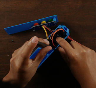

Then we put everything inside the 3D printed case. (stl files below)
You can power it with a USB to DC cable using a powerbank (Be sure to use a powerful powerbank before brighten the leds to the max, at least 5V 2A)

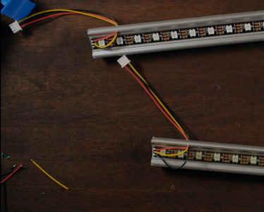

Step 4: Assembly the Wand

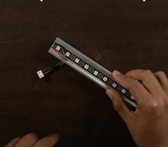

I will use a recycled aluminum tube of an old LED light as enclosure for the wand, you can find aluminum enclosures for led strips in any hardware store like the one in the first step.
I cut the tube in half to have a two parts light wand you can keep a long wand if you want, but I wanted this wand to be easy to store in my backpack.
I applied the LEDs strips with its double-sided tape into the aluminum tube, and made some small hole with a round file to pass the wires.
Then I soldered the wire into the pads of the LED strip Vcc for Positive, Gnd for Negative and, Data for Din.
Note: Be sure to solder the data cable into the Din pad.
The I secured the wire with some hot glue.
Extra step: Last I 3d printed some nut holders (file below) and glued them with epoxy glue, you can use 1/4" rivet nuts to easily give a mounting point to the aluminum tubes, but I couldn't find nut rivets this time. 1/4" nut rivets are just fine to mount the wand in a tripod for video purposes (WLED has also effects like fire flickering, Lightning, or TV effect), if you only will use the wand for light painting this step is not that necessary.

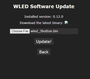

On the actual firmware of the WLED controller you have only two buttons available for configuration, but we connected 3 buttons, you can keep only two buttons working and follow the advanced configuration or you can upgrade the firmware to enable one extra button in a total of 3 buttons.
Firmware Upgrade
To increase the number of buttons, download the firmware .bin (Github File Link)
This firmware can be uploaded using the OTA upload menu
Config > Security >Updates>Manual OTA Update
We select the .bin file and press upload, this may take a couple of minutes to update and reboot. Once the controller reboots you will be able to see 3 buttons options in the menu LED Preferences.

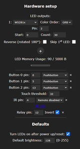

First, lets assign the buttons to a pin that we connected the buttons module previously.
Copy the configuration from above in the LED Preferences menu.
Then we go to the Time & Macros menu and scroll down to Button actions, here we introduce the actions of each button. Copy the configuration from above.

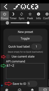

In favorites first we create the next presets:
First Preset ID 1
we deselect "Use current state" to enable the custom preset and enter the next text:
&T=2
This instruction toggle (turn on or turn off) the leds and it was assigned to button 0.
So button 0 now will turn on or turn off the LEDs.

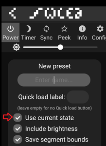

Setting up our Effects
We create an effect using the color and effects tabs, then we go to the favorites tab and click on New Preset and leave the "use current state" selected to store our actual effect in a preset from the eighth preset and onwards. Once we know which presets we will use for out photography we follow the next steps:
