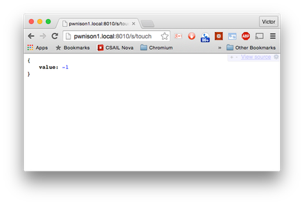

Step 4: Test the Board
Our board software includes a Web server that can be used to test the board's hardware. Before boxing up the board, you should make sure that all the sensors and LEDs respond as expected.
To test the sensors and LEDs, try the following URLs. Replace pwnison1 with your board's name, which can be set by the command
configure_edison --name
http://pwnison1.local:8010/blink?color=red&seconds=2
http://pwnison1.local:8010/blink?color=blue&seconds=2
http://pwnison1.local:8010/blink?color=green&seconds=2
http://pwnison1.local:8010/lcd?color=ff00ff&line1=Hello&line2=World
http://pwnison1.local:8010/s/alcohol
http://pwnison1.local:8010/s/touch

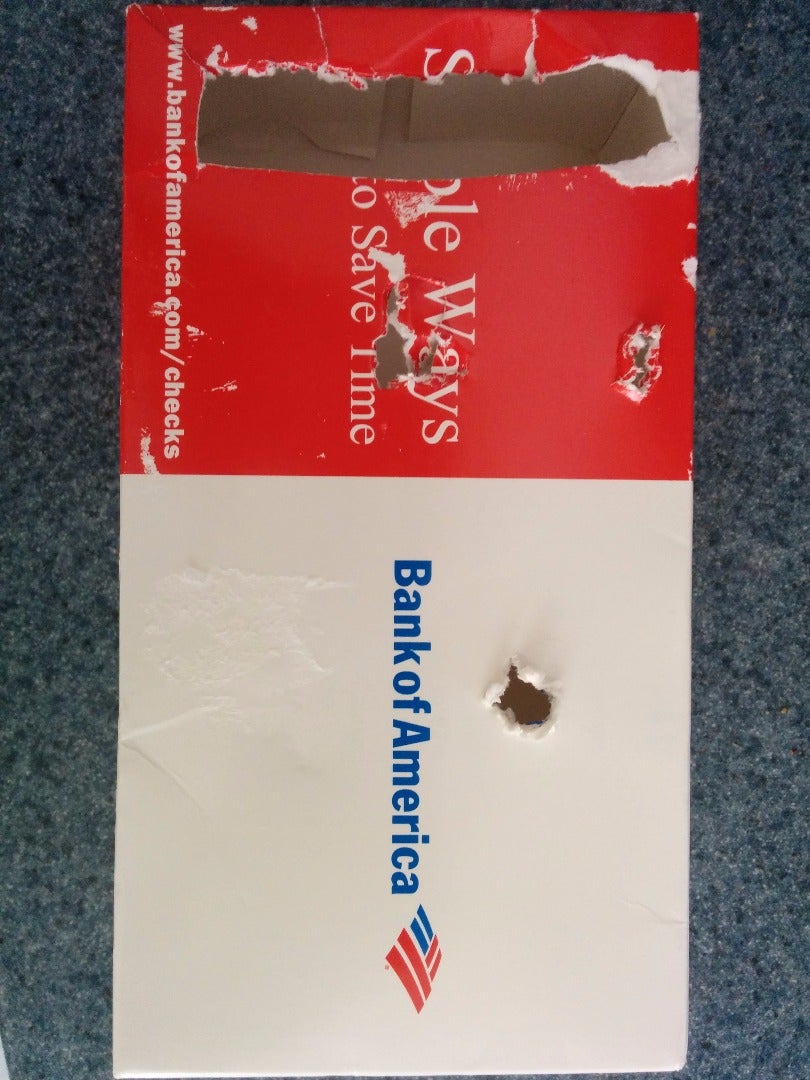

Step 5: Box Up the Board - Version 1
In Intel's Boston IoT Roadshow hackathon, we used a box for bank checks, because that's what we had lying around that was roughly the size of the Edison board.
The board fits very tightly vertically, which is good news for us -- it won't move around. It has some room on one of its sides, and we used that to store the battery.
We used transparent tape to keep things in place, and we used nail scissors to poke and cut holes in the box. We taped the gyroscope under the board, and we taped the battery near the end of the box. All the other sensors lie outside the box.
We made a special hole for the water sensor, because we're constrained by its short wire. The sensor needs to be in the cup, as deep as possible, so it'll trigger when the cup is empty or almost empty. Asides from that, we have one hole for the LEDs, and one hole for the other sensors and the LCD screen.
We cut out a strip of the box so we'd have room to plug in the battery right before our demo. We didn't know how long the Edison board could run on a 9V battery, so we used the USB power cable throughout the testing phase. We switched to battery power right before we started the demo.
