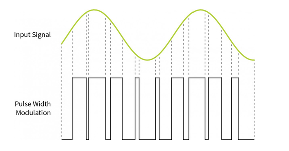

What is Class D Amplifier?
As the name suggests D, is a digital amplifier. It is also known as a switching amplifier that uses the transistors and MOSFETs as electronic switches and performs quickly switching between the supply rails. There is a modulator available in this amplifier that shifts the sampling frequency to the highest frequency. That is why they are used in audio amplifiers to enhance the quality of sound. Using pulse width modulation, this amplifier converts the input (analog) signal to digital pulses. Their efficiency varies from 80% to 95%.

Block diagram:
This class D amplifier works on the principles of the following block diagram. In this diagram, the analog signal is given as an input signal to the comparator or modulator. This modulator converts the analog signal to the digital pulse signal. This digital rectangular pulse has low amplitude when it passes through the low pass filter it will increase the amplitude of the original signal. At this stage, we are enhancing the quality of improving the sound level of the original signal. Then it will be converted again into an analog signal and a sound can be heard in the speakers. Now this time, you will be enjoying the music of better quality.
