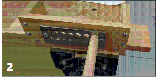

A woodworker can custom make dowels to suit the project by cutting a square piece of wood and running it through a dowel sizer – a die that cuts a piece of wood through various sizes until it is rounded to the desired diameter as shown in the following page.
The dowel sizer is a steel plate with various holes of sharp dies. The rod can be pounded through a succession of hole sizes or it can be mounted in a hand drill and pressed through the dies as shown in the photo 3.
The metal plate is mounted on the surface of a box designed to be held in a bench vise or clamped to a bench on the left and right out boards. Securing the plate in the vertical position makes pushing the rod through the die while the drill spins it. Body mass helps push the rod easier.

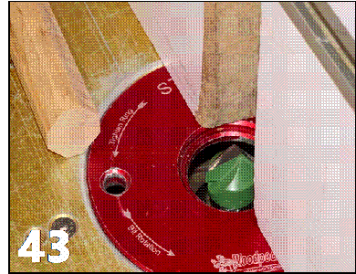

The rod that’s shown above has had the corners trimmed on the router table to 45o.

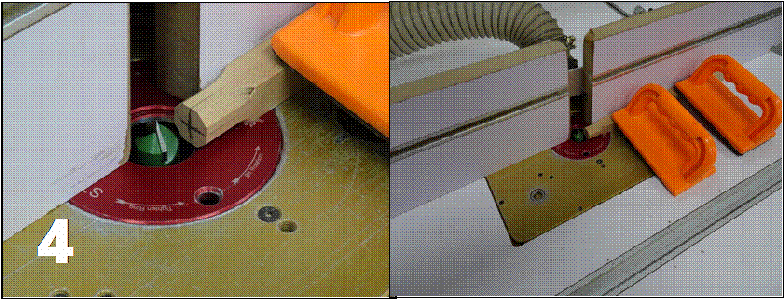

After attempting to safely move the rod across the table router bit with hand held orange paddles (see next page), it became obvious that a safer method was necessary. The result is the Bevel Ease 45.
James Vander Schaff, in his excellent video, “Making the Hidden Wood Dowel Hinge Box,” (https://youtu.be/o7NYRrgXNrg), showed a better way of preparing the rod for rounding: instead of trying to force a square rod through the dowel sizer, it became much easier when the corners were trimmed to 45o.
The photos with the orange paddles show the square rod on the router table with a bit to cut the 45o angle. While it is possible to use hand pad holders to pass the wood through the cutter, a safer method is preferred. (See photo 2).
A narrow piece of wood passed through the cutter needs to meet the following safety requirements:
1. It must be held tight to the fence;
2. It must be held firmly down on the table;
3. It must move laterally (from right to left) as the bit trims the corner; and,
4.Most importantly, the operator’s hands and fingers must be protected from the bit.
An additional benefit is that many rods can be trimmed without changing measurements after the initial setup.

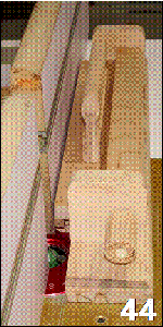

Bevel Ease 45is designed to trim the corners of a square length of wood prior to rounding it into a dowel. These photos (See photos 5) show the hold-down pad of the Bevel Ease 45 raised to accept the square rod.
Bevel Ease 45 Parts
The Bevel Ease 45 is a compact push stick. It’s made from a log given by a neighbor. The ends of the log were painted to seal the end grain and retard rapid and uneven drying.

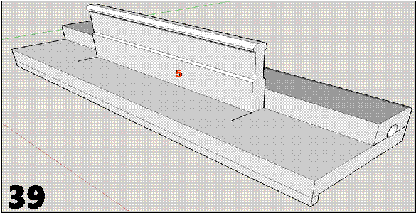

Step 1: Push Block Base (A) – ¾” X 3 1/8” X 16 ½”
1. Cut the base to size.2. Lay out the dimensions on the surface of the base. (Photo 7)
3. Bevel the top edges with a 1/4” to 3/8”round over router bit. Do the 2 end grain edges first. (Photos 8 and 9)
A push block as shown in the photo to the right will hold the narrow part of the base square against the fence and reduce the amount of chipping across the end grain.
Any chipping or tear out that may occur will be negligible and can be smoothed off when the edge grain is cut.

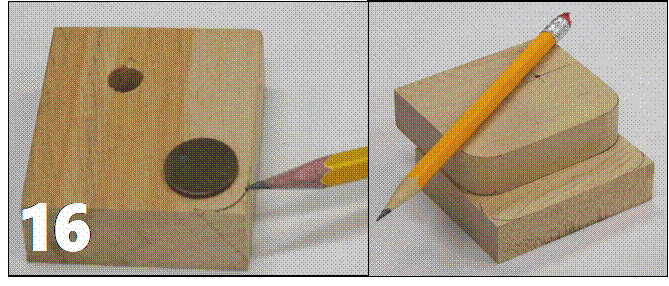

3. Trace circles on top corners. Select a coin with the diameter of your choice and trace around it on the two top corners. The diameter isn’t critical.
4. Trim the corners and sand them round to the line. (See photos 13 - 16)

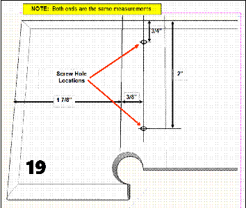

Step 3: Securing Mounting Blocks (B )
1. Place masking tape in the area of the mounting block and draw lines on it. Use a square to make sure that the lines are 90 degrees.
2. Lay out the lines on the base at both ends.
3. Use the brad awl to punch the four holes.

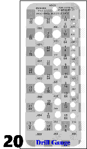

4. Select two thin brads and find the size using a drill gauge similar to the one at the right.
5. Find a drill bit the same size and lock it into the drill press.
6. Drill the two holes in each block. (See photos 19 and 20)

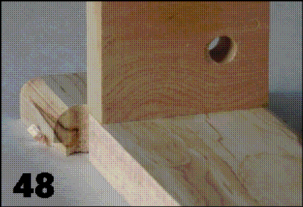

Step 4: Creating the Clamp Down Paddle (D)
The Clamp Down Paddle is designed to hold the square rod against the fence and down on the table. It will pivot to allow easy change of the rod position by flipping up and down.
__________
NOTE: It is made of four pieces of wood: 1.paddle base, 2. back, 3. hold-down bar, and 4. the handle. Cut the three pieces 1" longer and cut to length when glue has dried.
__________
1. Cut the paddle 1/2” x 3” x 12”. The space between the mounting blocks on the base is 11 5/16”. The paddle will be 1/16” narrower (11 1/4”) than the space between the mounting blocks to make movement easier.
2. Cut the back 1/2” x 1 1/4” x 12”.
3. Cut the hold-down bar 1/2” x 3/8” x 12”.
4. Glue the three pieces and trim to 11 1/4” when glue sets.

The Bevel Ease 45 can be used as a safe push stick on the router.

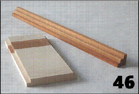

This 3/4” x 3/4” rod had to be shaped for corners of a box. It was clamped in the Bevel Ease 45 and used as a push stick across the router keeping the work firmly pressed down and against the fence.
Photos 45 to 47 show preliminary clamping of the test pieces.
The square length was easily cut on the Bevel Ease 45. Four pieces were cut from two rods the length of the box sides for the four corners.
It is anticipated that a project plan will be prepared for future publication. Part of that will be the hidden wood hinge for which the Bevel Ease 45 was designed using dowel sections.

Continual use will damage the stop locator as shown in the Photo 48.
The fact that the base is wood allows for easy repair. The worn piece can be trimmed on a saw and another stop can be glued on.

There was need for a tight fit for a steel spacer in a piece of wood.Three bits were drilled into in a piece of scrap wood.
The results revealed that the spade bit was a loose/sloppy fit. The Forstner Bit was snug. The twist drill gave the most accurate result - the spacer had to be pressed into the hole and was anchored for best use.
Before drilling into a piece of wood, consider the fit. The Bevel Ease 45 is designed to move easily and a loose hole (slightly larger) fit very well.
