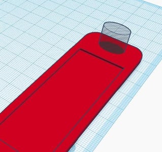

Step 1: 3d Printed Bezels - General Form Designed in Tinkercad
Picture 1
Here are a number of different bezels. They are mostly made the same way, with the overall shape being the main distinction between each of them. The 3d printed equivalent of a ‘bail’ or ‘jump ring,’ is the only other detail variation. Some have holes simply punched through the body of the bezel, other have a ‘ring’ of sorts added to the periphery of the bezel. One has a hanging hole hidden on the back of the bezel, and one has holes for a cord to go through the bezel. This last one would not have a deep inset, as the holes are located mid way down the thickness of the bezel. I will cover how I go about making these bezels, in the next section.

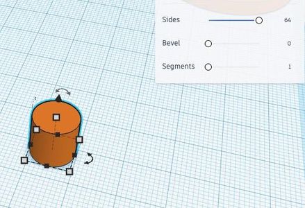

This sequence shows the very simple means of producing a three dimensional shape which will be exported as an stl file, for printing on the 3d printer. P2 shown the shape I have chosen - it’s the ‘circular trapezoid’ provided shape, in the Shape Generators section of the free elements within Tinkercad. I make a duplicate by holding down ‘shift + alt’ on my mac, and pulling the black arrow upwards - this duplicates the shape. It’s perfectly possible to ‘copy and paste (cmd c, cmd v)’ but the alt-shift method ensures the items stay aligned, which is useful.
After getting the duplicate, I make it 2-3 mm smaller in x and y, make it a hole, rather than a solid (P4) then drop it back into the original shape (P5). I make sure the hole is one or two mm above the base plate of the original object, then group them from the options in the top right corner of the Tinkercad screen. This has the effect of a Boolean operation, adding a hole to a solid, makes a cavity the shape of the hole (P6.)
At this point, I decide to make a hole for the pendent cord, so choose the cylinder object from the tray of Basic Shapes, I make it the diameter I want (the height is entirely irrelevant at this point. Picture 7 shows that there are options to have the circle either relatively ‘low poly count’ or quite smooth. I want it to be as smooth as possible. Because I want a ring around the bezel hanging hole, I wish to cut a smaller hole out of the middle of this cylinder to make it into a ring. Yes, I could use the various rings and donuts offered in the shape generators - but I am stubborn, I have always used this method, and I guess I always will. So, Picture 8 shows the two objects. I now either make and group both of these elements as holes or as solids, it doesn’t matter which. As they are grouped, I can use the alignment tool to get the elements where I want them in the main object. Picture 9 shows them aligned centrally in the narrow axis of the bezel, and to the right edge of the bezel. Now I make the smaller cylinder into a hole. Picture 10 shows this arrangement.
It’s one of the features of any Boolean operation that you make sure the order of processes takes place properly, in order to get the result you want.
If I cut the hole out of the ring, then weld the ring to the bezel, there won’t be a hole in the bezel. So I must perform the operations in the right order. I make the larger cylinder the same height as the bezel, then I weld the ring to the bezel, by making sure I select just those two items, and clicking the ‘group’ button. I can then select the newly combined bezel+ring, along with the small cylinder hole, and perform the Boolean union, thus ‘drilling’ a hole into the bezel, through the centre of the ring.
All extremely simple, but important to get right to achieve the effect you seek.

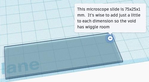

Pictures 24 to 34 show the whole process. P24 is the slide, though I make the ‘void’ shape just a smidgen bigger than the official dimensions, for ‘wiggle room.’ P25 is the finished bezel, and I will go through how I get to this final shape, here.
Picture 26 shows the starting point, which is a beveled cube. The controls for the bevel parameters are shown. As mentioned before, Tinkercad has the unfortunate ‘feature,' that bevels scale, rather than maintaining their dimensions. So, Picture 27 shows the rigamarole I have to go through to get the final shape I want, which is a flat oblong with rounded corners. The best way i have found (I am sure there are others :) ) is to make three beveled objects, two cubes and one stretched cube. By joining them together as in Picture 27, I can end up with a stretched 3d rectangular volume with consistent bevels. In P28 I show how I then add a hole on top and a hole on the bottom, which are both Boolean joined to the oddball stretched beveled rectangle, to produce a rounded corner flat object as in P29.
I use the initial ‘slide’ object to cut a void with right angle corners into the rounded rectangle then I cut a nice oval cord hole in the end.
