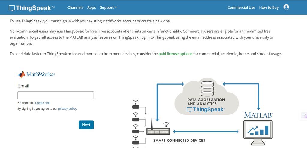

Step 1: How to Create a Account in Thingspeak
Visit ThingSpeak: Go to the ThingSpeak website at [ThingSpeak thingspeak.com].
Click on Sign Up: In the top right corner of the homepage, you'll see a button labeled "Sign Up." Click on that button.
Fill out the Registration Form: On the registration page, you'll be asked to provide the following information:
  • Username: Choose a unique username that you'll use to log in to your ThingSpeak account.
  • Email Address: Enter a valid email address that you want to associate with your ThingSpeak account.
  • Password: Create a strong password that includes a combination of letters, numbers, and special characters. Make sure it's something you can remember easily but difficult for others to guess.
  • Confirm Password: Retype your chosen password to ensure there are no typos.
Create Account: Once you've filled out the form, click on the button that says "Create Account."
Verify Your Email (Optional): ThingSpeak might send a verification email to the address you provided. Check your inbox and follow any instructions in the email to verify your account.

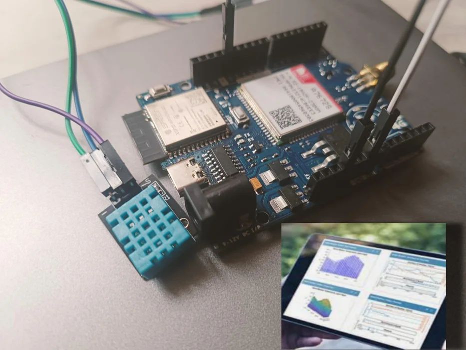

Step 4: Code for Mqtt
   PROJECT: Bharat Pi 4G Board Sample Code for data push to Thingspeak Cloud
   AUTHOR: Bharat Pi
   FUNC: 4G testing with HTTP call to Thingspeak cloud server.
   SIMCARD: 4G sim cards from Airtel/Vodaphone/Jio/BSNL can be used.
            To test HTTP request ensure you have data plan.
   IMPORTANT: Configure the APN accordingly as per your Sim provider
   GPS: If you have bought Bharat Pi wtih GPS board then you need to connect
        the GPS antenna to the UFL connector and antenna should have clear sky visibility
        preferrably on the terrace or open field.
   TODO: (Before you upload the code to Bharat Pi board)
   1) Change APN as per your Sim provider
   2) Change the Thingspeak API key as per your account/setup
   3) Use a power adapter 9V 2amps as the 4G module requires enough power to operate
   DESC: This script will connect using 4G sim and makes a http call
   to a Thingspeak cloud server setup as per your Thingspeak API key.
   COPYRIGHT: BharatPi @MIT license for usage on Bharat Pi boards
#define TINY_GSM_MODEM_SIM7600 //TINY_GSM_MODEM compatible for 7672 as well
#define TINY_GSM_RX_BUFFER 1024
//#define DUMP_AT_COMMANDS true
#define SerialAT Serial1
#define SerialMon Serial
#define UART_BAUD   115200
#define PIN_DTR     25
#define PIN_TX      17
#define PIN_RX      16
#define PWR_PIN     32
#define LED_PIN 2
#include <TinyGsmClient.h> //Lib version - 0.12.0
#include "SSLClient.h" //Lib version - 2.1.7
#include <PubSubClient.h> //Lib version - 2.8
// certificate for https://mqtt3.thingspeak.com
// DigiCert Global Root G2, valid until Sun Mar 30 2031, size: 1720 bytes
// const char* rootCACertificate = \
// "-----BEGIN CERTIFICATE-----\n" \
// "MIIEyDCCA7CgAwIBAgIQDPW9BitWAvR6uFAsI8zwZjANBgkqhkiG9w0BAQsFADBh\n" \
// "MQswCQYDVQQGEwJVUzEVMBMGA1UEChMMRGlnaUNlcnQgSW5jMRkwFwYDVQQLExB3\n" \
// "d3cuZGlnaWNlcnQuY29tMSAwHgYDVQQDExdEaWdpQ2VydCBHbG9iYWwgUm9vdCBH\n" \
// "MjAeFw0yMTAzMzAwMDAwMDBaFw0zMTAzMjkyMzU5NTlaMFkxCzAJBgNVBAYTAlVT\n" \
// "MRUwEwYDVQQKEwxEaWdpQ2VydCBJbmMxMzAxBgNVBAMTKkRpZ2lDZXJ0IEdsb2Jh\n" \
// "bCBHMiBUTFMgUlNBIFNIQTI1NiAyMDIwIENBMTCCASIwDQYJKoZIhvcNAQEBBQAD\n" \
// "ggEPADCCAQoCggEBAMz3EGJPprtjb+2QUlbFbSd7ehJWivH0+dbn4Y+9lavyYEEV\n" \
// "cNsSAPonCrVXOFt9slGTcZUOakGUWzUb+nv6u8W+JDD+Vu/E832X4xT1FE3LpxDy\n" \
// "FuqrIvAxIhFhaZAmunjZlx/jfWardUSVc8is/+9dCopZQ+GssjoP80j812s3wWPc\n" \
// "3kbW20X+fSP9kOhRBx5Ro1/tSUZUfyyIxfQTnJcVPAPooTncaQwywa8WV0yUR0J8\n" \
// "osicfebUTVSvQpmowQTCd5zWSOTOEeAqgJnwQ3DPP3Zr0UxJqyRewg2C/Uaoq2yT\n" \
// "zGJSQnWS+Jr6Xl6ysGHlHx+5fwmY6D36g39HaaECAwEAAaOCAYIwggF+MBIGA1Ud\n" \
// "EwEB/wQIMAYBAf8CAQAwHQYDVR0OBBYEFHSFgMBmx9833s+9KTeqAx2+7c0XMB8G\n" \
// "A1UdIwQYMBaAFE4iVCAYlebjbuYP+vq5Eu0GF485MA4GA1UdDwEB/wQEAwIBhjAd\n" \
// "BgNVHSUEFjAUBggrBgEFBQcDAQYIKwYBBQUHAwIwdgYIKwYBBQUHAQEEajBoMCQG\n" \
// "CCsGAQUFBzABhhhodHRwOi8vb2NzcC5kaWdpY2VydC5jb20wQAYIKwYBBQUHMAKG\n" \
// "NGh0dHA6Ly9jYWNlcnRzLmRpZ2ljZXJ0LmNvbS9EaWdpQ2VydEdsb2JhbFJvb3RH\n" \
// "Mi5jcnQwQgYDVR0fBDswOTA3oDWgM4YxaHR0cDovL2NybDMuZGlnaWNlcnQuY29t\n" \
// "L0RpZ2lDZXJ0R2xvYmFsUm9vdEcyLmNybDA9BgNVHSAENjA0MAsGCWCGSAGG/WwC\n" \
// "ATAHBgVngQwBATAIBgZngQwBAgEwCAYGZ4EMAQICMAgGBmeBDAECAzANBgkqhkiG\n" \
// "9w0BAQsFAAOCAQEAkPFwyyiXaZd8dP3A+iZ7U6utzWX9upwGnIrXWkOH7U1MVl+t\n" \
// "wcW1BSAuWdH/SvWgKtiwla3JLko716f2b4gp/DA/JIS7w7d7kwcsr4drdjPtAFVS\n" \
// "slme5LnQ89/nD/7d+MS5EHKBCQRfz5eeLjJ1js+aWNJXMX43AYGyZm0pGrFmCW3R\n" \
// "bpD0ufovARTFXFZkAdl9h6g4U5+LXUZtXMYnhIHUfoyMo5tS58aI7Dd8KvvwVVo4\n" \
// "chDYABPPTHPbqjc1qCmBaZx2vN4Ye5DUys/vZwP9BFohFrH/6j/f3IL16/RZkiMN\n" \
// "JCqVJUzKoZHm1Lesh3Sz8W2jmdv51b2EQJ8HmA==\n" \
// "-----END CERTIFICATE-----\n" \
  SECTION: Set APN based on your sim card
    AIRTEL: "airtelgprs.com"
    BSNL: "bsnlnet"
    VI: "portalnmms"
    JIO: "jionet"
const char apn[]  = "airtelgprs.com"; //Change this as per your Sim card operator
  SECTION: Set Thingspeak cloud specific
const char broker[] = "mqtt3.thingspeak.com"; //change this to as per your server MQTT broker
const int port = 1883; //MQTT port
const char* channelID = "2456524"; //Thingspeak channel ID, set this to as per your channels on thingspeak
//thingspeak MQTT Client ID settings. Refer thingspeak MQTT settings
const char* mqttClientID = "Ow0UFh47FzsqHj00JAAuGgo";
const char* mqttUsername = "Ow0UFh47FzsqHj00JAAuGgo";
const char* mqttPassword = "7kq9ySBZd7oxWZln3v58/7R8";
#ifdef DUMP_AT_COMMANDS
  #include <StreamDebugger.h>
  StreamDebugger debugger(SerialAT, SerialMon);
  TinyGsm modem(debugger);
#else
  TinyGsm modem(SerialAT);
#endif
TinyGsmClient client(modem);
//SSLClient secure_client(&client);
PubSubClient  mqtt(client);

Step 5: Code Explanation
1 Libraries and Definitions
#define PIN_DTR 25
#define PIN_TX 17
#define PIN_RX 16
#define PWR_PIN 32
#define LED_PIN 2
  • These lines define which modem to use and set up buffer sizes and serial port configurations.
  • Libraries for handling GSM communication, SSL, and MQTT are included.
2. Certificate Definition (Commented Out)
cpp
Copy code
// const char* rootCACertificate = ...
  • The certificate for SSL connection to ThingSpeak is commented out. This can be included if secure MQTT communication is required.
3. APN and ThingSpeak Configuration
  • The APN (Access Point Name) for the SIM card and MQTT broker details are set. These values must be updated according to the SIM card provider and ThingSpeak channel configuration.
4. Modem Functions
void modemPowerOn(){ ... }
void modemPowerOff(){ ... }
void modemRestart(){ ... }
void printLocalTime(){ ... }
void mqttConnect(String payload) { ... }
  • Functions for powering the modem on and off, restarting it, and connecting to MQTT are defined. The mqttConnect function publishes data to ThingSpeak.
5. setup Function
void setup(){
modemPowerOn();
String res;
// Initialize Modem
// Connect to Network
String payload;
double temperature1 = 32.9; //Dummy variable to send temperature
double temperature2 = 36.2; //Dummy variable to send temperature
payload = "field1=" + String(temperature1) + "&field2=" + String(temperature2) + "&status=MQTTPUBLISH";
mqttConnect(payload);
  • The setup function initializes the modem, connects to the network, and sets up a payload with dummy temperature data. It then calls the mqttConnect function to publish the data to ThingSpeak.
6. loop Function
void loop(){
while (1) {
while (SerialAT.available()) {
SerialMon.write(SerialAT.read());
while (SerialMon.available()) {
SerialAT.write(SerialMon.read());
  • The loop function continuously reads from the modem and prints any data to the serial monitor, allowing you to debug and see real-time modem responses.
Key Points to Remember
  1. APN Configuration: Ensure the APN is set correctly for your SIM card provider.
  2. ThingSpeak Configuration: Update the MQTT credentials and channel ID with your own ThingSpeak details.
  3. Power Supply: Use a 9V 2A power adapter to ensure the modem operates correctly.
  4. Debugging: The code includes extensive serial prints for debugging purposes.
This setup is designed for testing and should be customized based on your specific requirements and environment. Make sure to replace the placeholder values (APN, MQTT credentials, channel ID) with your actual data before deploying the code.
