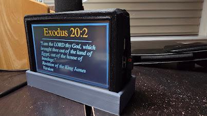

Bible Verse Clock is an RPi project that displays the bible's Book, Chapter and Verse to indicate the current time. This project is based on similar gadgets available for sale retail, albeit without the premium price.
For instance, the picture above would indicate 8:02 pm in 24 hour time. The time format can be switched between 12 and 24 hour formats.

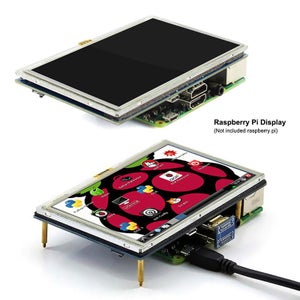

  3. HDMI Display like the 5" display from Elecrow shown.
  4. 90 degree Micro USB adapter, to make packaging easier

Step 1: Description of Build
The verses randomly change every minute to display a new Version and book.
This software is written so that it must have Wifi access to display the verses. It uses a free Bible API at https://github.com/wldeh/bible-api. There are many Bible versions to choose from. The software uses a dictionary listing 10 or so of the available versions. This file is called 'bible_dict.py' and can be edited to add or remove versions. The software will randomly pick a Bible version, and book to display. So if the same version is desired each time, you will want to delete all but the desired version from this file.
If the verse is not properly returned from the API or if there is not a book, chapter and verse that matches the current time, then the current time alone will be displayed.

Connect the display screen you plan to use. If the display also is a touchscreen, then install the necessary driver and calibrate it. Also, as mentioned enable 'VNC' from the Preferences menu on the desktop. There is a file called 'touchscreen 5inch instructions.txt' that provides more info on setting up the touchscreen if needed.
The development unit built used a 5" touch display that mounted directly to RPi header, so a 90 degree power adapter was needed so the power cord came out the back.
