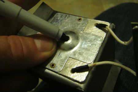

Step 4: Heater Post
The heater for the tank is taken from a 10-16 watt coffee mug heater. I found mine for $3 USD at a goodwill thrift shop. When taken apart, the heating element is as pictured. Only the heating element and electrical cord is required. The heating element should be insulated from the AC by some type of insulator. As pictured, my heating element uses mica as an insulator.
The following steps should be taken:
- Put the heating element in the middle of one side of the tank and mark with a permanent marker
- Score around the center mark
- Strip any zinc-coating on a machine screw (flat-top) using muriatic acid (hydrochloric acid)
- Apply solder to the center mark
- Apply solder to the screw head
- Solder the screw to the center mark
- File around the screw to remove excess solder
- Shorten the screw as necessary

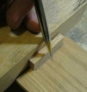

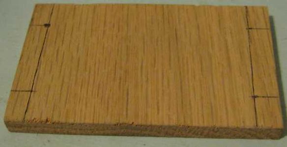

Step 5: Body Holes
The following steps are taken to make screw-holes for the body:
- Trace the edge of one piece against another
- Make lines from either edge 2 times as far away as you want the screw hole
- Make an 'X' in the box formed
- Indent the center of the 'X'
- Drill the center of the 'X' using a drill press
- Tape the drilled piece to its complement
- Drill through the pre-drilled piece with a hand drill to make room for the screw

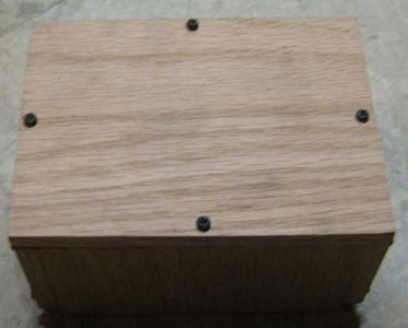

Step 8: Top and Bottom
In this step, create the bottom:
- Trace a scrap piece along each edge
- Make center-holes on each edge
- Pre-drill and test-screw the base
