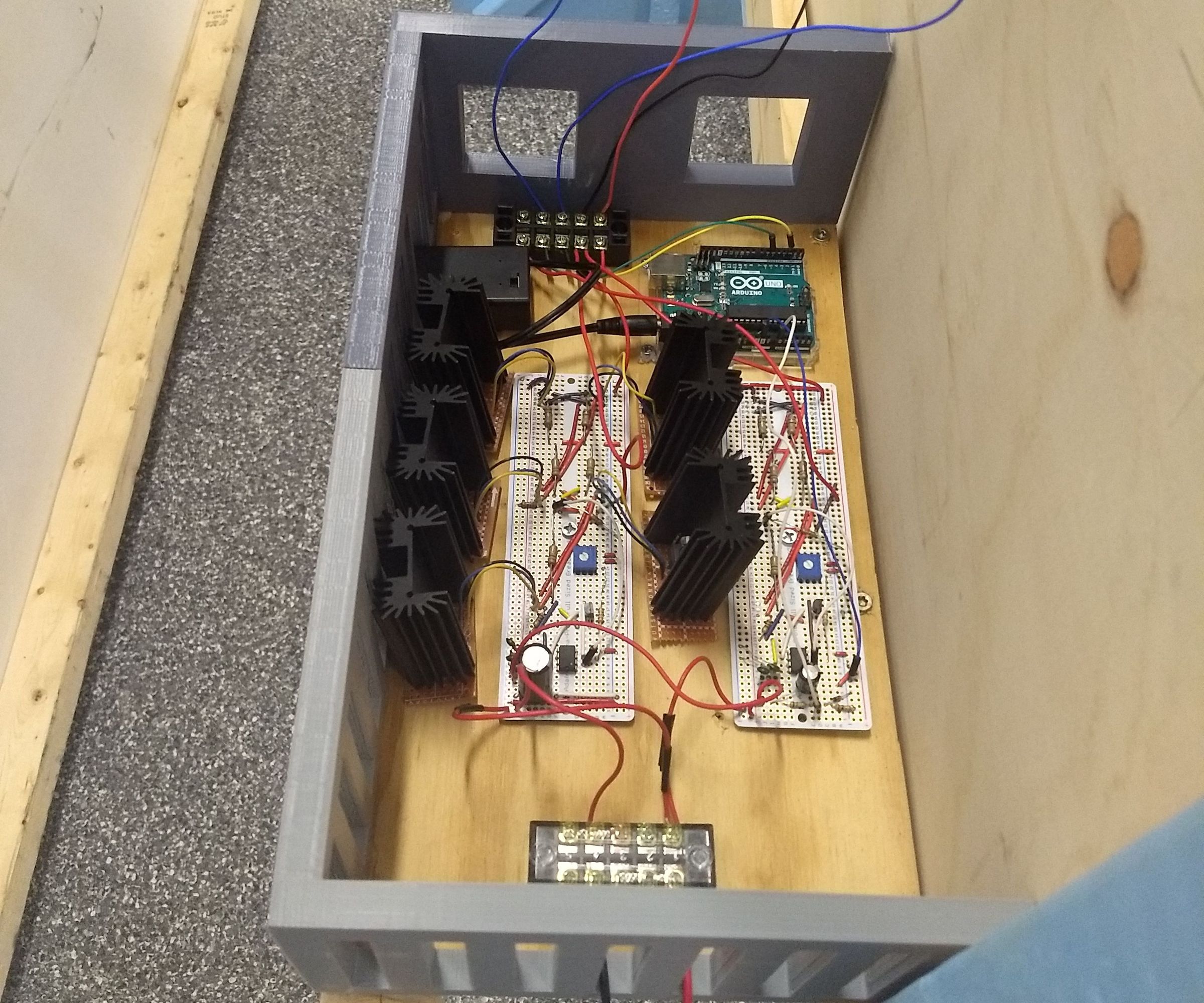

The circuit we built has two functions. The first is to regulate the variable DC voltage input from the motor to a constant 5V DC output used to power the lights. The second is to utilize a voltage divider to reduce the voltage output from the motor to between 0 and 5 volts. This output is then input into the Arduino Uno's analog input port which has a limit of 5V. The Arduino Uno is coded to activate specific lights at a certain voltage. This code is provided below.
The circuit shown in the schematic above is used to distribute the current evenly between 5 linear voltage regulators (lm338). These regulators can not simply be placed in parallel to distribute the load because differences in their internal components causes slightly different outputs from each. The linear regulator which provides the highest output ends up taking the entirety of the load. Utilizing the circuit above stabilizes the outputs and distributes the load evenly. The lights draw a maximum current of around 1.5A configured using the chosen colors (48 blue 2 red). Coding the lights to all be white would create the maximum current drawn (3A). The voltage is regulated down from a maximum of 28V to 5V. This is a 23V difference. 23V x 1.5A = 34.5W of power that must be dissipated as heat. This is why distribution of the load between the regulators is so important to the team. If one regulator was to take all the load, it would exceed its maximum operating temperature.
First, build the circuit on a solder-less breadboard. A rather large capacitor (we used a 2200 uF) will need to be placed across the motor output to decrease its noise. This cleans up the input that the Arduino is receiving and makes the light display more consistent (lights not flashing erratically). However, if you would like to create a seizure producing machine, save $2 and void the capacitor. Next, incorporate the voltage divider circuit. Run a jumper wire from the voltage divider to the Arduino Uno analog input A0. Jumper the Arduino into ground as well. See drawing attached. Further information for wiring the lights can be found at the link below:

In the picture above you might notice that there are two circuit boards built. Originally, the team planned to use 10 lm338 linear voltage regulators but after further testing, determined one circuit with 5 was substantial. However, the board we ended up not needing contained the voltage divider, hence it is still utilized.
Out of personal preference, the team decided to jumper the linear regulators to the circuit board. This allowed us to mount them a little more freely and better support the large heat sinks. Solder all the components from your prototype to your new solder board. We used a permaproto board so that the circuit would be an exact replica when moving it over from the solder-less breadboard. Two 5 gang terminal blocks were utilized to create quick disconnects from the motor and the lights.
