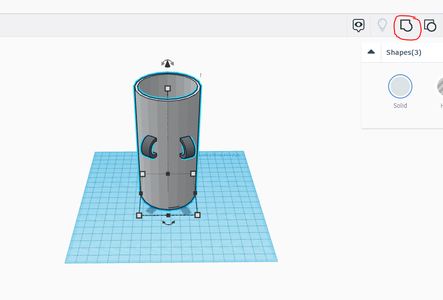

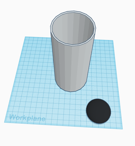

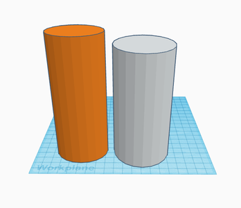

1) Select the "Basic Shapes" category on tinkercad and pick the cylinder
2) Increase the shape of the cylinder to the size of your normal water bottle
3) Now, pick another cylinder from the category, but this time instead of using the solid option click "Hole"
4) Once the hole category is picked shape the cylinder to be slightly smaller in width compared to the first cylinder
5) Place the second cylinder into the first cylinder making any adjustments in shape that are needed
6) Once the cylinder is centered, click the left button on your mouse and drag it over the cylinders
7) Then, click the "group" button located at the top right of the screen (this will make the needed hole in the cylinder)
8) Now, place another cylinder on the working surface and flatten/widen the shape
9) Once the shape is as large as the bottom of the big cylinder place the large cylinder over it
10) Drag your mouse over the object once again and click "group" (this will allow both items to stick together)

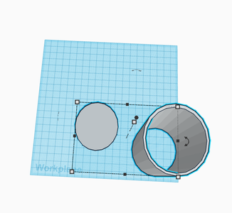

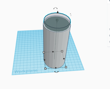

11) Now move the view to the back of the cylinder
12) In the same group (Basic Shapes) click the tube shape twice
13) Place a square on top of the tube (make sure the square is on the hole category)
14) Once the square is in the middle of the tube drag your mouse over both of the shapes and click "group"
15) Repeat for the second tube
16) Then, turn both tubes vertically onto the cylinder and drag the mouse over the shapes and click group so that they can stick together

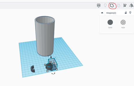

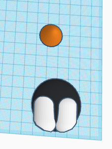

1) In the "Basic Shapes" category pick the half-sphere shape along with two capsules
2) Click the "Hole" section for both capsules and then bring them over to the half-sphere and shift them until horizontal
3) Once they are horizontal, place them both onto the half-sphere, leaving a little space in the middle
4) Drag the mouse over the shape (while holding the left click) and then click the "group button"
5) Now that the half-sphere has two holes in it go back to the "Basic Shapes" category and once again choose two capsules
6) Fill the holes with both capsules (adjusting their shape when needed) and then drag the mouse over the object and click group so that they stick together

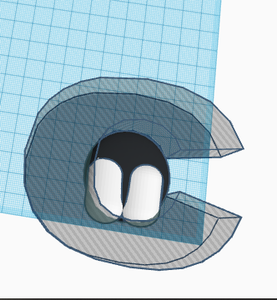

7) Now find the "C" in the "Design Starters" category, click "hole" and then expand it
8) Bring the inside on the C near the base of the half-sphere, one its place surrounding the shape then drag the mouse over the shape and click group (This helps smooth any edges out)

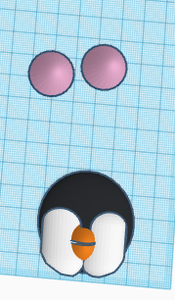

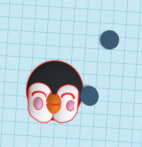

1) Now, pick two more paraboloids and bring them over to the white section in the middle of both cheeks
2) Drag your mouse over the face and click "group" to stick everything together once it's placed where you want
3) Then, in the "Basic Shapes" category click two ring shapes
4) Once again click a square with the "hole" feature on and place it over the ring and group them together
5) Once both the ring shapes are cut in half drag them over to the base and place them near the top of the white section to create eyes (adjust the shapes where needed)
6) Drag the mouse over the whole shape and click "group"

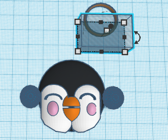

Step 4: Adding Accessories
NOTE: With each shape picked, choose your desired color before grouping it with other objects
1) Now going to the "Design Starters" category pick two "Sphere Pattern V9" shapes
2) Bring both spheres over to each side to symbolize earmuffs
3) Drag the mouse over the whole shape and click "group"
4) Then, go back to the "Basic Shapes" category and click the ring shape
5) Cut the ring in half by placing a square over it in the "hole" feature, drag your mouse over it, and click "group"
6) Once the ring is cut in half, make it bigger and have both ends connect to the "Sphere Pattern V9" shapes
7) Drag your mouse over the whole head and click the "group" button to finish the penguin head

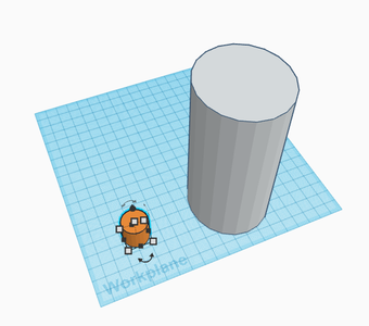

Step 5: Putting Everything Together
1) Now that the penguin head is finished face the head vertically
2) then, move the head over to the big cylinder
3) Once the head is positioned onto the cylinder drag your mouse over everything and click the "group" option so that everything stays together
