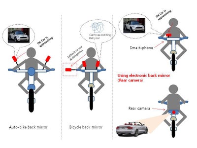

Step 1: Operation Concept
When you look at the picture above, you can immediately understand the bicycle back mirror problem.
When you mount the back mirror on the bicycle handle, it will show only you.
If you mount the back mirror at the side of a handle with some strange and abnormal method, it can show you the backside view.
But looking at the mirror is a little bit difficult and you should turn your head to look at the mirror.
But if you can look backside view on the small screen mounted on the handle, it will be more convenient and safer to ride a bicycle.
By the rear camera attached to the bicycle luggage compartment, you can easily look at the backside view on the smartphone screen.

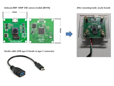

Of course, the most important part is the camera.
I bought this camera module from a local (Korean) Internet web store for about 35$.
The technical specification of this camera is like below.
  • Sensor: 8MP 1/4” IMX219
  • Resolution: 8MP 3264H x 2448V
  • Data Format: MJPG/YUY2
  • Field of View (FOV):H=62.2°, V=48.8°
  • IR Sensitivity: Integral IR filter, 650nm IR Filter, visible light only
  • Frame Rate: MJPG 15fps@3264x2448, 30fps@1920x1080; YUY2 30fps@640x480
  • Adjustable Features: Brightness, Contrast, Saturation, Sharpness, Gamma, White balance.
  • Power Supply: USB Powered 5V
  • Working Current: MAX 200mA
  • Operating Temp.: -4°F~167°F (-20°C~+75°C)
  • Dimension: 31mmx31mm
As I'm using a camera module for the first time, the technical specification above seems like encrypted text.
Anyway, this module seems quite popular among many DIY users.
Another important part is the USB gender cable that connects the camera module to the smartphone.
Regarding the smartphone, you can use any brand if the phone can support OTG peripherals such as USB token or OTG camera module introduced above.
I'm using my daughter's unused old LG phone for this project.

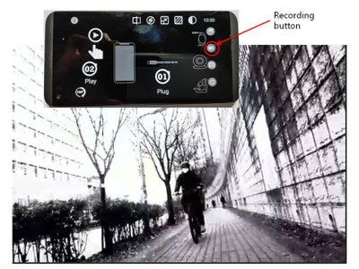

Step 5: Backside Viewing With Smart-phone
This is an actual photo showing the rear camera in action.
You can see a wide-angle of unobstructed backside view through the smartphone screen.
I'm using the OTG view app which supports the USB OTG camera module.
The smartphone is LG Q8 that is previously used by my daughter but becomes useless now as she got a new one already.
After installing the app from the Google play store, no specific setting is required as the app is running like a plug-and-play style.
When you push the recording button of the OTG view app, video captured by a camera can be stored as a file.
As an additional benefit of using the rear camera, you can have video footage of your bicycle journey!
Step 6: Video Captured by Rear Camera
This is the OTG view application menu screen and still image of video captured by the app.
When you select the recording button, you can record video from a camera.
When you look at video footage, the originally captured video changed from color to black & white.
There is a video setting change menu is included in the OTG view app.
As overall video on the smartphone screen is not clear under the sunlight, I had changed application settings to less bright and more black&white like mode.
When you look at the video, another bicycle rider is approaching behind.
As I saw his bicycle on the smartphone screen, I signed him to pass by mine using my hand and at the same time, I moved out from his way.
He seems a little bit surprised by my preemptive and very quick concessive action.
