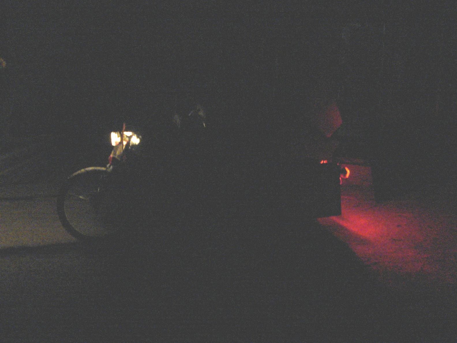

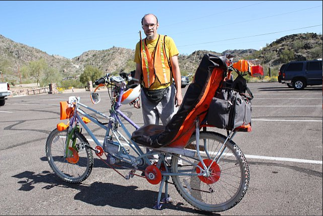

The first pics below show the bike lights in comparison to a typical car, in a parking lot with a closed and half-darkened store behind them, and a typical mercury-vapor streetlamp off to the side and above. Keep in mind the battery for the lighting system hasn't even been charged in over a week before these images, and is nearly to the point where the longer LED strings will stop lighting (this actually happened on the way home, due to my forgetfulness, thankfully since the rear signals are shorter strings they still worked fine). Yet even so, they're bright enough to be noticeable here. They're several times brighter on a full charge.
The second (new) set of pics are in my carport, taken the same day as the second video above. The pics are in 4 sets, from just before sunset (on the other side of the house from the carport, so no direct sunlight shown) to just after nightfall, and show the bike from each side, with the left turn signal blinking. Where possible, there are images from each lighting condition and angle both with and without the signal, but because the camera has an unpredictable short delay after pressing shutter button and actually capturing the image, I could not get a shot of each even after dozens of tries. I did get many in-between states, oddly enough, where one LED set was in the process of dimming, and the other just beginning to light, which is very strange, since that time period is *extremely* short, compared to the time each LED set is actually fully on (see the video for example timing). None of the in-between pics are posted, as they're not important to how the light works. :-)
