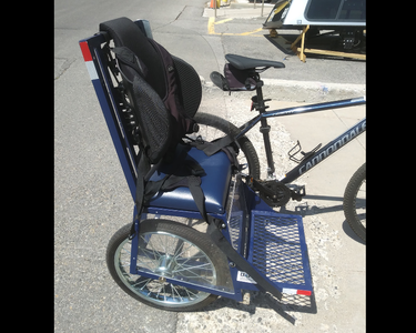

When a bicycle takes a turn the rider will lean into the turn so they can remain balanced at higher speeds. This side car has an axel that allows the bike to tip back and forth while still keeping the wheel of the side car on the ground. This allows the sidecar to move independent of the bike and will prevent the sidecar from throwing the bike of course when either the bike of the side car go over a bump. The side car is also easily removable by removing the axel that connects the sidecar to the bike.
This project will focus of the more on the mechanical principal of the axel and less on the actual fabrication of the seat of the sidecar.

Attach the clevises to the bracket such that the axel can be slid through both clevises with the ball joint end rod in place. This will later assist in measuring the height at which the coupling nuts will be welded to the frame. A cotter pin can be used at one or both ends of the axel to make the side car easily removable.
U-bolts can be slid through the slots in the bracket to attach the bracket to the frame of the bike. Heat shrink can be used around the U-bolt to prevent the hardware from scratching the frame of the bike.

With the side car standing next to the bike the height of the attachment point can be determined.
Weld the coupling nuts to the frame so that the whole thing stands level. If additional spacing is needed to separate the side car from the bike a short section of angle iron can be used.

If the side car pulls the bike to the right or left the angle of the sidecar wheel can be adjusted by changing how far the ball joint end rod is threaded into the coupling nut.
If the spacing is greater on the front ball joint end rod than it is on the back, the wheel will be angled out and the bike will pull to the right. If the spacing on the front ball joint end rod is less than on the back, the wheel will be angled in and the bike will pull to the left.
