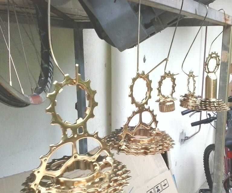

cut a slot in the tubing at the top and check the assembly, the design allows for the top cog to have a slight backward angle which helps make it more of a feature. Mitre the end where the top cog goes and cut spare tubing to create the in full that holds the cog in place. Sorry no photo, I'll update when I do the next one. Braze all components together, you could Epoxy them together but brazing is better and more traditional.
Step 6: Braze All Parts Together
Step 7: Mitre Tube
Step 8:
The finished product spray painted with a primer and a few top coats of gold spray paint. Ready for the winner of the "Golden Cog"
