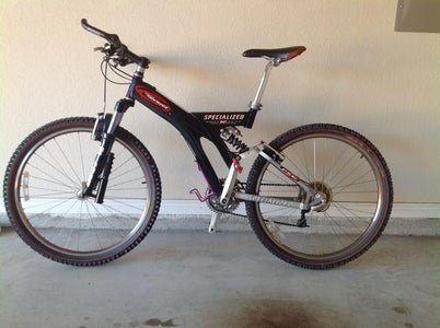

I like to ride my bike in my neighborhood but sometimes I ran into dogs. So I decided to carry my expandible baton. Since my bike is a 1997 it does not have disk brakes, but the fork is newer so it came with the holes to mount disk brakes. I decided to mount 1" PVC to where the caliper mounts to, and use it to carry my baton.

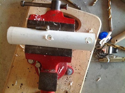

Cut PVC to desired length.
Drill holes to PVC. You will need two 10mm metric screws, 1/2" in length.
