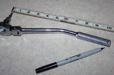

Step 5: A Ratchet Makes the Job Easier
Resetting the hex key until the scale reads the desired figure is not difficult, but using a ratchet makes the job easier. You will need 3/8 inch drive metric hex key bits and a ratchet with a long handle, though.
Measure the ratchet handle and mark the point where the scale should attach.
Step 6: Make an Attachment Loop for the Scale
The hook on your scale will not fit around the handle on your ratchet. With a piece of heavy wire or a rod, such as from the handle of a paint can, make a loop that can hang over the handle of your ratchet and catch the hook on your scale.

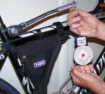

Step 7: Using the Ratchet to Torque a Bolt
Place the hex key bit in the bolt head. With one hand keep the hanger loop from sliding on the ratchet handle. Attach the scale. With the other hand pull the desired weight to yield the proper torque.
Using a fisherman's scale like this one theoretically allows you to torque bolts up to 500 inch pounds. Just remember that the reading on the scale will be one-tenth the torque figure.
