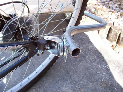

Step 1: Two Out of Three Ain't Bad...
I try to avoid using the dropout with any carrier/trailer project since wheel realignment can sometimes be a pain. Instead I use the fender mount bolt holes above the dropout to keep axle and carrier adjustments and maintenance separate.
In most cases even If I use the dropout hole an adapter is required to match the frame bolt holes with the holes needed for the carrier. In this trailer project I decided to use a 2 inch diameter caster wheel to keep the cost very low since I found a good one at the flea market for a dollar and a caster wheel provides two of the three required axis of rotation.
To mount the caster wheel to the frame I thought I would need to make an adapter but then the idea hit me that all I really needed was to cut parallel flats on the caster wheel and drill holes to match the fender mounts.
This initial design resulted in a hitch design that worked only if I did not stray from level ground, rest the bike on the kick stand or let it fall over. It soon dawned on me that a good trailer hitch design required provision for all three axis consisting of yaw, pitch and roll. Since I live in a hilly area with many bumps, gulleys and inclines this setup, which lacks roll, was not good enough to get me past the driveway so I started thinking about a way to add roll at very low cost..
Step 2: Adding Roll
The first trailer hitch redesign borrowed from the original hitch design by again using a folded piece of tire bolted to the caster wheel base plate to form a loop in which to insert and hold the conduit tubing. This worked very well to provide the trailer with roll and I did not need to go further, but went ahead and replaced the piece of tire with a piece of PVC. Note that the one inch PVC has to be notched for the three quarter inch u-bolt to fit. Either configuration depends upon the materials at hand. Even other materials like upholstery strap might do or a washer with a large enough hole for the conduit to slide through, just the u-bolts. To be honest I liked the feel and fit of the piece of tire much better and will probably use it again. If I do I'll add it to this instructable.
I used a couple of u-bolts to secure a piece of one inch PVC pipe to the caster wheel base plate through which I ran the end of the three quarter inch piece of conduit tubing connected to the trailer. Bolts are run through the conduit at each end of the PVC (or loop of a piece of tire) to keep the conduit from sliding back and forth in the tire or PVC. I used wing nuts and washers to secure the bolts which did not have full threads. To keep the bolts and washers from rattling I added a piece of bungee cord.

    you have the whole trailer weight supported by one little bolt through the fender eyelet, i think? seems like it might be a little weak, no?
    0
    watermelon
    watermelon
    Reply 13 years ago on Introduction
    (Previous reply info added to the Instructable) I must have been thinking about the conduit/plywood attachment rather than the fender mount when I replied to your question the first time. Veuillez m'excuser. On this bike there are two one quarter inch fender mount eyelets instead of only one. If you do the math the total cross sectional area is only a hundredth shy of the axle cross sectional area. Most likely the dropout or frame will bend before both of these bolts break at the same time. I have never had any problem with the weight they can carry. If you only have one eyelet then you can always make an adapter plate and include the axle for support. In fact, due to the strength of this connection, I have a remote disconnect planned for an Instructable in the future. No point in having your loaded trailer pull you with it off of the cliff.

    ah-ha - didn't know how the previous answer related! ok, i see, this makes more sense. i did see the two bolt arrangement, but figured it was just to make a bigger plate, didn't realize there was a double eyelet on the frame. definitely much better.
    0
    watermelon
    watermelon
    Yeah, I must have been thinking of my own immediate concern for the possible weakness of the conduit/plywood junction, having long since dismissed any concern for the strength of the dropout eyehole bolts. With only one eyehole though I would definitely include the axle or some other type of clamp mechanism to the frame. You'll see shortly in an alternate configuration of the caster wheel how the thickness of the adaptor plate by accident is way overkill. One eighth thickness would have been lighter and still thick enough (same thickness as the dropout) to work. Normally I like to go overboard on material strength for things on which personal safety depends but in this case safety may depend on weakness. I may end up cutting a weak point as a break-a-way so that in the event of a mishap, such as a truck hitting the trailer, that the trailer will not take the bike and me bod with it.
