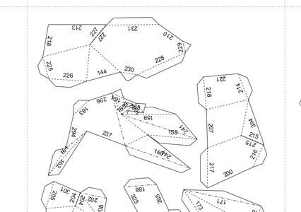

Step 5: Pepakura and Mock-up Development
Pepakura is a software that allows the user to ‘unfold’ a 3D model into a series of flat triangles (https://tamasoft.co.jp/pepakura-en/ ). These individual pieces can then be printed out, cut out and then refolded and stuck together to recreate the 3-Dimensional model in real life. While in principle this is very simple it is actually very difficult to do. Most 3D models (stl, obj files) tend to have lots of curves. Due to paper only being able to fold in 1 direction the software unfolds every single curve into a huge array of overlapping triangles that can’t actually be cut out and folded together
To account for this the polymer count of the model needs to be reduced, ie the model needs to become simplified and more geometric. The term Low-poly is used. In Blender the command Decimate allows the user to simplify the model by specifying the number of polygons the model is made from. Too few and the model loses all detail and becomes an abstracted form, too many and the Pepakura file cannot be cut and folded.
The assembly of these various separate triangles is a very straight forward process but is very tedious as accuracy is essential in cutting, folding and gluing. Small imperfections add up and can ruin the assembly as parts will no longer fit together. The model of the first head was comprised of 15 pages.
In previous Pepakura projects a craft knife and a metal ruler was used successfully to cut out parts but this is incredibly time consuming and not aways accurate. A modern electronic vinyl cutter is a far faster and more accurate automated solution. The Silhouette Cameo 4 vinyl cutter was used to cut out every part. The pages where first printed at Postnet on Heavy 8 cardboard at R8.00 per page. In order to align the cutting software and machine with the printed pages a software add on is required: Pepakura Viewer 4 for Silhouette Cameo 4. This exports the pdf file of the parts with registration marks in the corner of each page. These registration marks match the printed marks on the card pages. The software also exports the file as a DXF which the vinyl cutter is compatible with. The machine is then able to scan these marks to cut along the correct edges corresponding with both the dxf file and the printed card. Each page needs to be manually attached to the Vinyl cutter’s adhesive cutting mat and the correct file loaded. It took about 60 seconds per sheet as opposed to 1-2 hours of hand cutting it would usually take if a manual approach was taken.

Step 7: Big Head Model-Template Making
The large model was created virtually the same as the smaller model but on a significantly larger scale. The size of the model was limited by the door size at the University of Johannesburg as this sculpture was assembled in the workshop and then transported to the studio for the future projection projects. The size of the sculpture was then scaled to be 2.5m tall, 1.6 metres wide and 1,15m deep. 3mm corrugated cardboard was chosen to be the most suitable material for this process as firstly it is cheap, at R10.00 per 1100mm by 900mm sheet, the material is strong but lightweight and finally it is able to be cut on a laser cutter. With these parameters in place the model could be modified to become suitable for this form of assembly. The model was sliced in front of the ear leaving just the face to reduce the size, scale and scope of this project. The file was then imported into Blender and decimated to reduce the polygon count. This obj. file was then imported into Pepakura and unfolded. The cut lines need to be manually chosen and are illustrated below as orange lines.
Keeping the pieces as large as possible is very useful to reduce assembly time, keeping in mind the size of the cardboard sheet that they must fit onto. Pieces that are too thin, delicate or unnecessary complicated were simplified using the smooth edge and join/disjoin face commands in Pepakura. Once each separate piece was created, they were then organised to fit onto the cardboard sheet’s pages in the software. Filing up the the page with as many pieces as possible while leaving 15-20mm gap between each for easier cutting.
Step 8: Laser Cutting Parts
As the eventual model needs to be folded along demarcated fold lines there are two methods that were explored. Firstly, the laser was set to half the standard power to score along the fold lines and full power for the edge. This would work well for a solid material but as corrugated cardboard has a series of ridges throughput its inside the depth of the score line was uneven and folding was not always accurate. The second method was far simpler and more successful. All fold lines were converted into dashed lines. 20mm dash followed by a 20mm gap and then a 20mm dash. Then all lines were cut on the laser cutter. The dashed lines guided the fold but had enough material between each piece to add strength and accuracy to the model.
Due to the 3mm thickness of the cardboard flaps would not be suitable for the assembly as they were when paper was being used. The flaps would raise the mating faces too much creating an inaccurate model. Instead, the flaps were removed and hot glue was used. The numbers used to align the pieces were unable to be cut/scored in the cardboard so as soon as each cardboard piece was cut, they were all hand labelled according to the digital document. This process was essential as assembly would be impossible without them.
