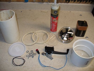

Step 1: Things You Will Need
1. About a foot of 4" plastic DWV pipe. A 9" piece will be the flashlight body and 2 half inch long pieces will be rings to hold the lens guard.
2. A PVC 4"x4" hub.
3. Sealed beam lamp #4546. Still made and sold online.
4. A 6V lantern battery. About $8.50 at Lowes. They have cheaper ones, but the Duracell is alkaline and is made in the USA!
5. A round piece of clear plastic, 4 1/2" in diameter. For the lens guard.
6. Silicone caulk.
7. A screen door handle with button.
8. A pushbutton switch.
9. Screws to hold on the screen door handle, and 2 1 1/2" long 1/4" sheet metal screws of lag screws. To hold the battery.
10. Wire - about 2 feet of #20 wire.
11. 2 feet of screen window spline.
12. A PVC 4" test cap. Forms the back of the flashlight.

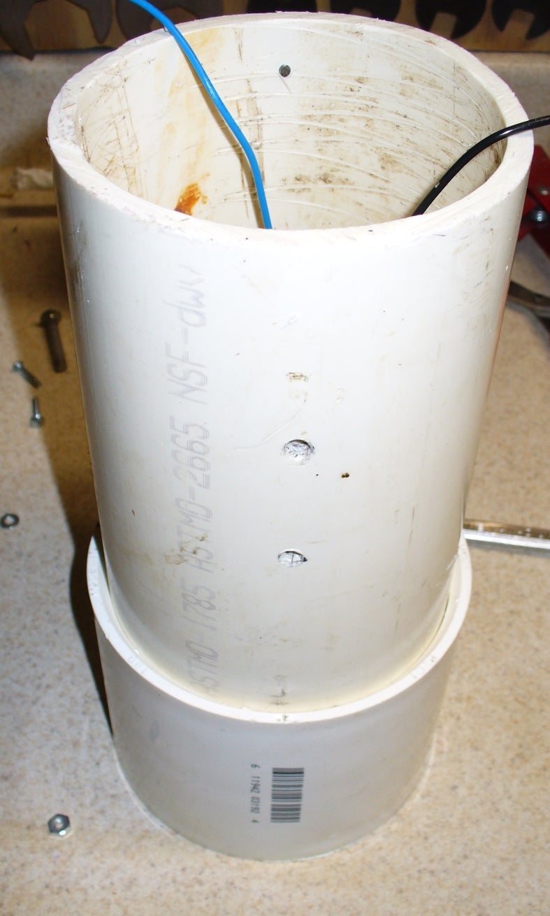

Step 2: Body of the Flashlight
The PVC pipe is the body. It should be about 9" long.
Starting with a longer piece of pipe, cut 2 1/2" wide 'rings' from it. These will be used for the lens guard in step 7. Then cut off enough to make the flashlight body 9" long.

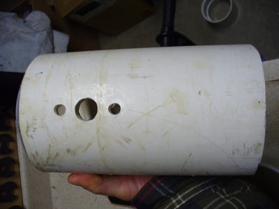

Next, drill holes in it to mount the screen door handle and the switch.
The 2 small holes are for the handle and the larger hole is for the pushbutton switch.
The button on the screen door handle will turn on the light!

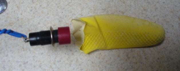

Step 3: Make the Switch Waterproof.
Before installing the switch, put a finger from a rubber glove over it.
When the switch is tightened down, the rubber will keep out water.

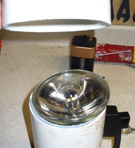

Step 9: Put the Business End Together.
Place the lamp on the top of the pipe and push the hub over it.
Caulk it first. You could use solvent weld glue, but then it could never come apart, and the lamp couldn't be replaced.
