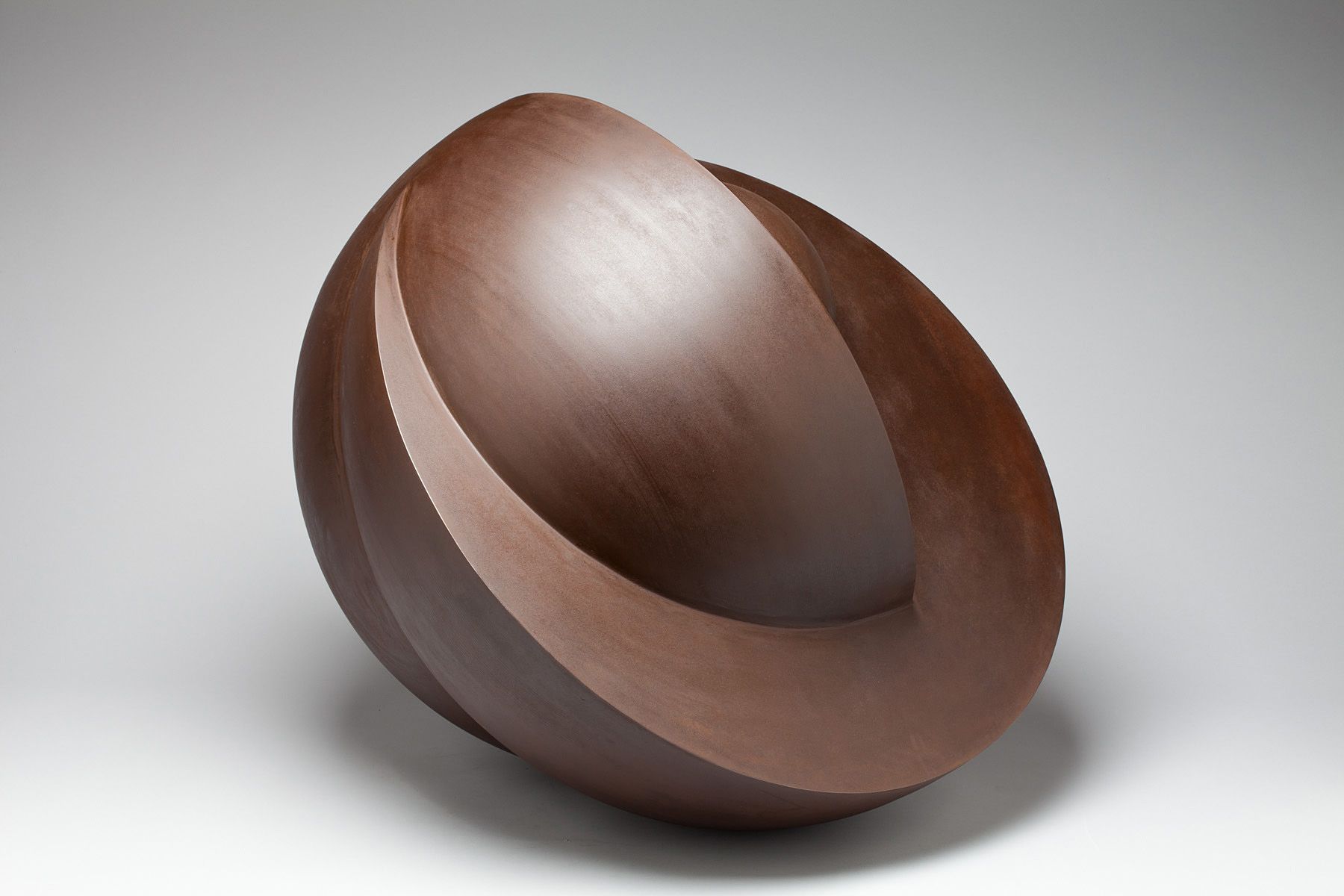

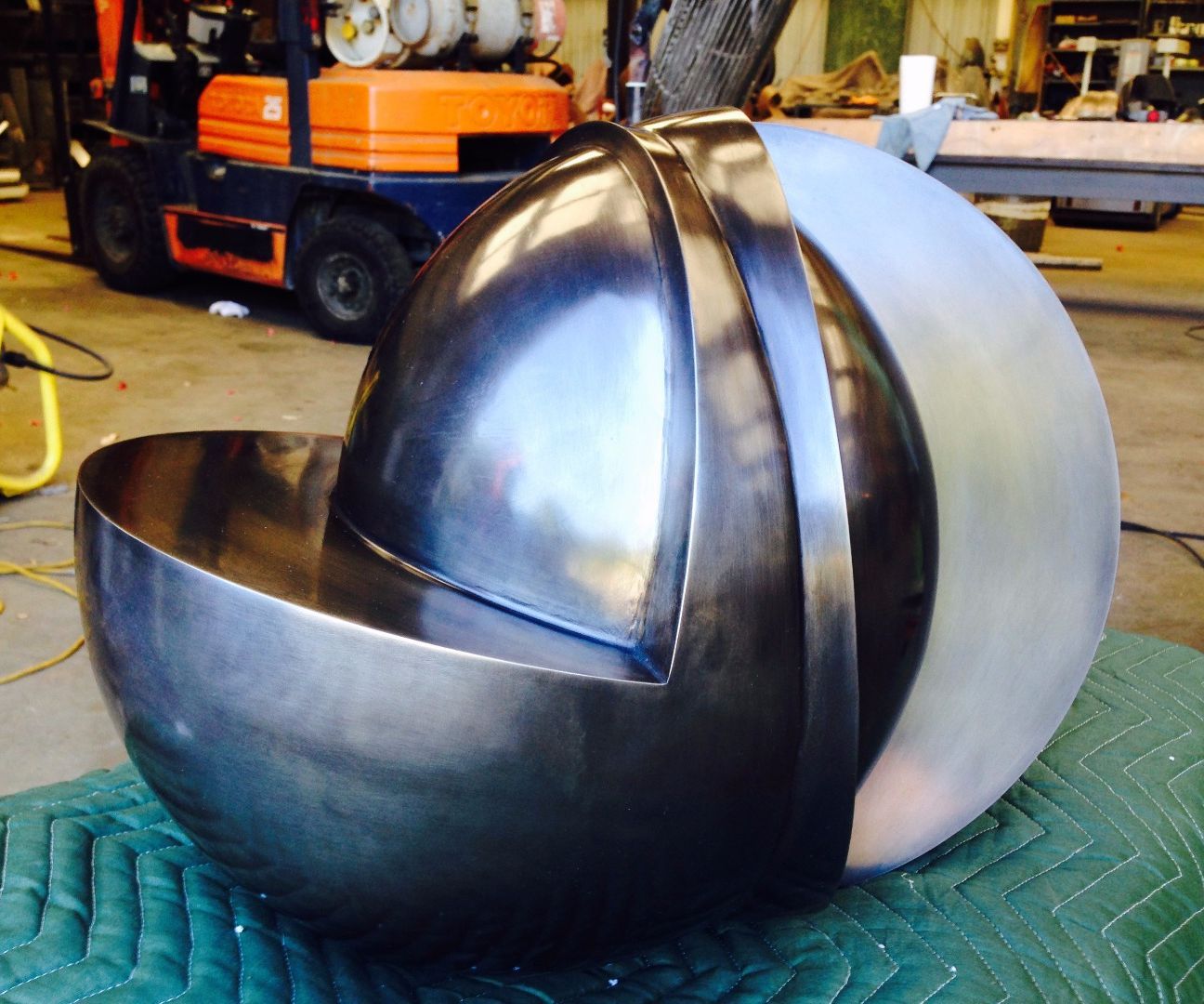

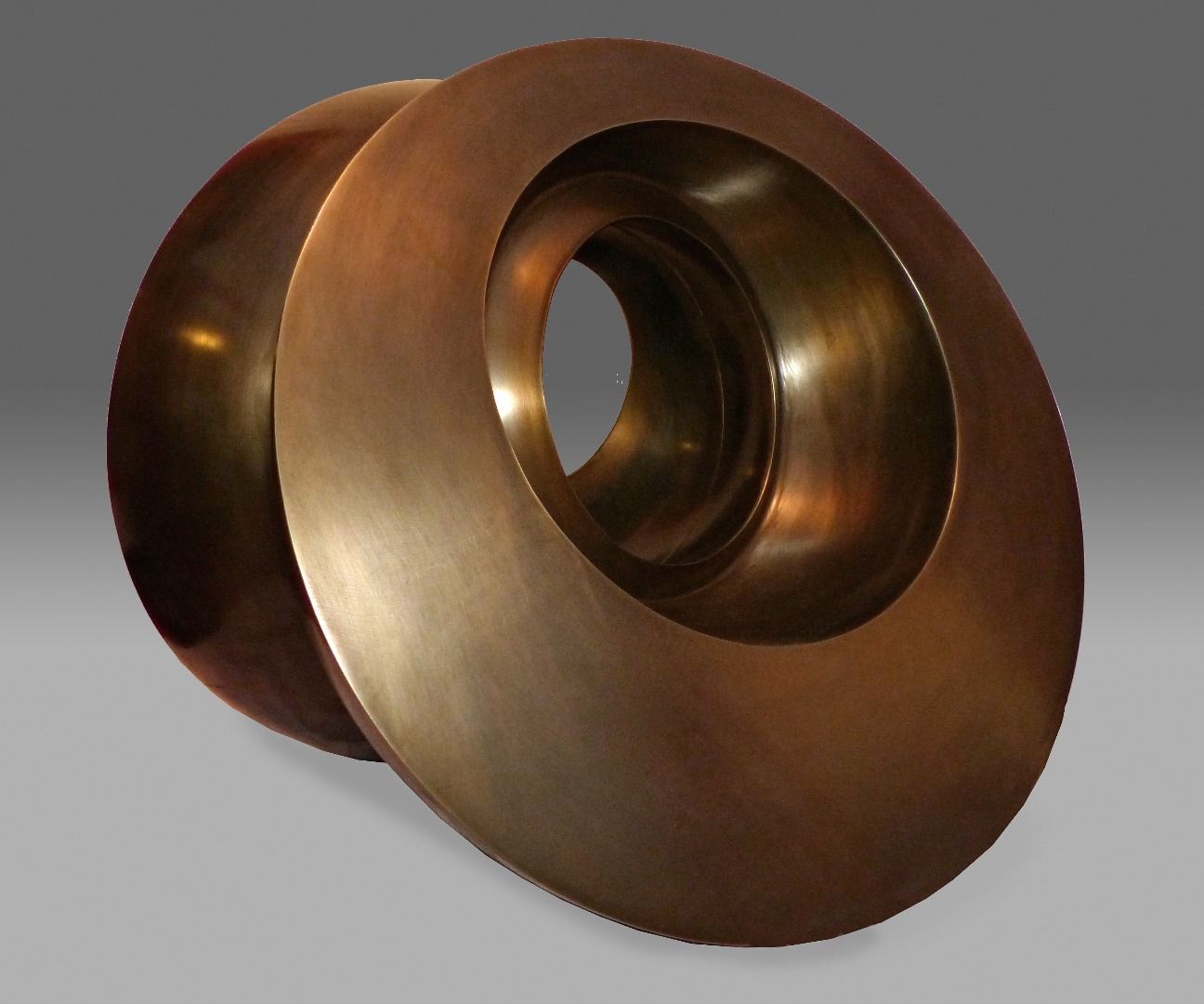

The commission called for a vertically oriented sculpture with a relatively small footprint. My work often begins with primitive forms and lately has consisted of spherical elements. Not the best shape for vertical work. But, an ellipse is elemental too: it can be drawn using a simple formula, can be fabricated without too much trouble and is also the path that celestial bodies take as they hurtle around the sun. Here's an ellipse drawn in 3DS Max that is 119" x 42". Why 119" instead of an even 120"? At 119", this shape can be laser cut out of a 10 foot plate of stainless.
