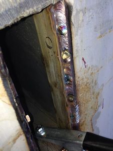

I would generally MIG weld a sculpture of this scale, but given that it was stainless with a fine finish I decided to TIG weld it. For the most part, I pulse welded to have greater control, especially in the tight areas that would be difficult to finish later. Check out the really boring movie above if you're curious about the pulse. Not especially instructive, but at least you can hear and see the pulse. More welding details: 308 L welding rod was used.
The sculpture was initially tacked together and was then "stitched" until the piece was fully welded. There were also about 20 plug welds, some of which are evident in the 4th photo in this step. The sculpture has a series of interior structural elements that are connected to the skins of the hollow forms by plug welding. These ended up being kind of a nightmare, but more on that later. The last photo shows how I set up my TIG torch so I could drag the cup on the metal and maintain a consistent arc length. This was the end of the fun part: on to grinding.

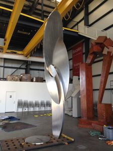

Step 7: Preparing to Weld the Base Plate
The piece is now done (mmmm, shiny) and now needs to be welded to a 1" stainless base plate. The base plate was clamped and the sculpture set inside a water jet cut hole to allow for welding on the top and bottom of the plate. I was a little worried about deflecting the metal in the sculpture when welding, so I clamped some heavy aluminum plates just above the joint to act as heat sink and stiffener.
Step 8: Welding the Base Plate
I beveled the top of the base plate to prepare the joint, and then tacked the sculpture to the base. Then it was stitched and completely welded. The piece was then turned and welded on the bottom leaving a 1" gap to allow condensation to drain. With the base, the sculpture weighs in at 1,650 pounds. Finally, I signed the piece before the last step: cleaning.

Step 10: Presto
Zip, zip, it's done. I'll be back with photos from the install in another month or so.
