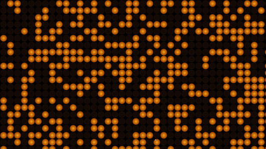

I like the so-called SuperComputer Panel, that BigClive has on some of his youtube videos.
I don't have the hardware to make a real analogue one, so I had a take at a software version, well at 3 versions actually.
One version using an ESP8266 with a built-in OLED Display
One is using an Arduino driving a MAX7219 led matrix driver.
And the third one is purely software, implemented as a Processing sketch.
The idea is to have an array of blinking pixels/leds that are randomly slightly desychronized at each refersh. After about 30s the illusion is quite satisfying to me.

Step 1: ESP8266 With Built-in OLED Display
The sketch is using the Adafruit SSD1306 library to drive the OLED Display.
It's using 3 arrays to track the pixels state and their on/off time
bool bits[32][32]; // display cells states
uint32_t on_time[32][32]; // state change trackers
uint32_t off_time[32][32];
The heart of the sketch is the process_bits() function that iterates over the cells and change their states.
Each time a cell is turned on/off a random delay is added/substracted to the cell's period.
This delay was set by trial and error.
With the current setting, all cells start synchronized and start to diverge quickly.
After about 30s, the illusion of an old Super Computer Panel is set and the pixels seem to light rather randomly but with some kind of running patterns.

The display_bits() iterates over the bit array and draws the pixels.
These are actually 4x4 filled rectangles in order to resemble actual LED/Lamps.

Step 4: Processing Version
I also implemented a version purely in software, just for fun and because I like the Processing creative coding environment.
It's also in the same git repo.
