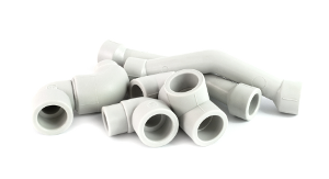

- Less than 2 feet of 2" PVC piping
- PVC DWV 90 Degree Hub x Hub 2" Elbow
- 3x PVC DWV Hub x Hub 2" Coupling
- 1x DWV Flexible PVC 2"x2" Coupling
