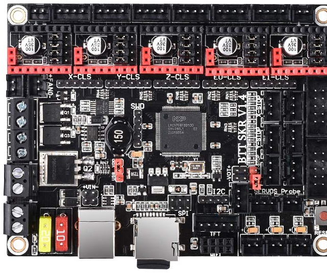

Step 2: Setting the I2C Address on the EEPROM Module
1st we need to set the address on the I2C bus to the default that Marlain uses.
- The RobotDny EEPROM Data Module on this module setting the 1 & 2 micro jumper switches to on will set it to be 0x50 address.
- The NOYITO-AT24C256-EEPROM-Memory-Interface is already set for a 0x50 I2C address.
- The Comimark-AT24C256-Interface-Storage-Arduino, set all jumpers next to the IC (as set in the image); this will set the I2C address to a 0x50 and disable write-protect.
- The BigTreeTech EEPROM module is already set for a 0x50 I2C address.
Step 3: Wiring the EEPROM Module to the BTT SKR Pro V1.1
RobotDny EEPROM Data Module, NOYITO-AT24C256-EEPROM-Memory-Interface, & Comimark-AT24C256-Interface-Storage-Arduino; we need four female-to-female jumpers.
For the BigTreeTech EEPROM module, the switch settings need to match what is shown in the photo and use the ribbon cable included with the module.
Wire as shown in the diagram for the module you are using.
