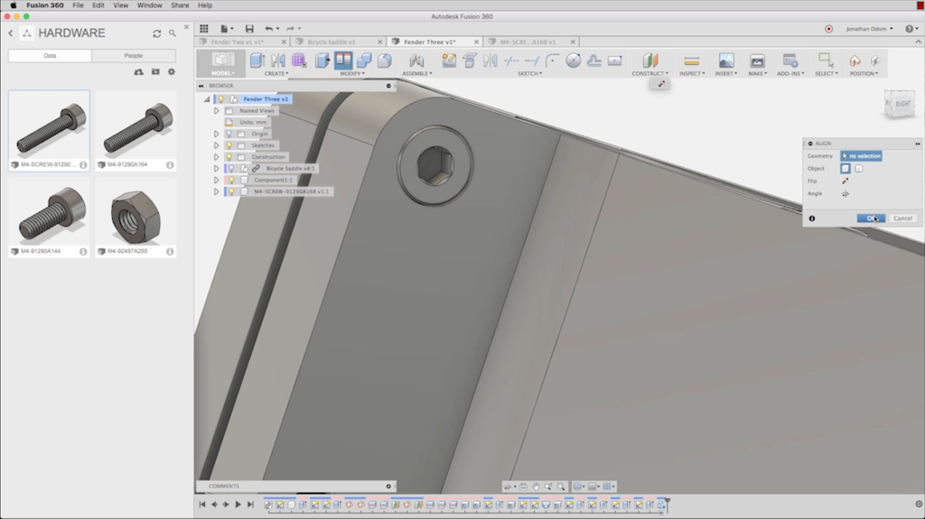

Modify > Align
To add the screw model to my design, I right click on the model and choose “Insert into Current Design”. This brings in a link to the file and lets me place it.
I go to Modify > Align and click the circular edge on the end of the screw cap, then click the outside edge of the circle on the clamp feature. This is a quick way to place the model exactly where it belongs.
