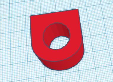

Step 26: My First Time Ever Using Tinkercad
I had never used Tinkercad before but I have seen people using it in Instructables so I decided to try 3D-printing some legs for my bike stand.
I was surprised how easy it is to make a simple shape like this in Tinkercad, so I had them printed and used the feet to prevent that the rebar will scratch the floor.
Originally I thought about making the feet from wood, but these red 3D-printed feet look much better.
