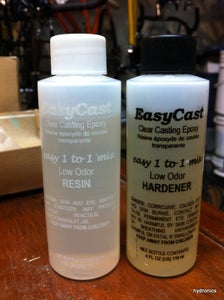

Epoxy Mold , from TAP plastics, $11.95
Heat transfer paste from Radio Shack ~$6.
Step 2: Weld the Medicine Bottle Mold
So I started with a medicine bottle to create a mold for the light.
I used a propane torch to heat up a bicycle handle bar and form a medicine bottle to the bar.
Then wire the parts, load them into the medicine bottle, and pour in the 2-part epoxy.

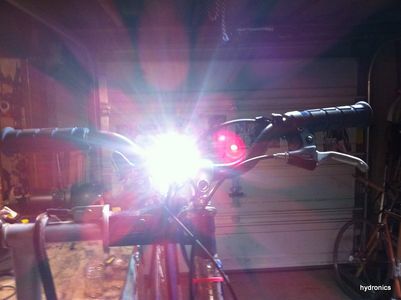

Step 3: 2nd Generation RGB
I decided to try something a little different here....
I used a full color RGB LED
Kingbright LED High Power (>0.5 Watts)
So I added switches to get the Blue, RED, and Green to go well Blue, Red or Green and then light up all three to get white....
the only trick was You have to put a resistor in front of the RED when you power all three LEDs so that when you wire everything in parallel, the RED LED does not become the path of least resistant and absorb all the power.  A 20ohm resistor seemed to do the trick.
After throwing my 'switches' so everything is in parallel I got a 1.8 voltage drop across the red LED, 0.8v across the resistor.  So it came out to be 2.7 volts across the two lonely Green and Blue LEDs to make a pretty much White front light.
