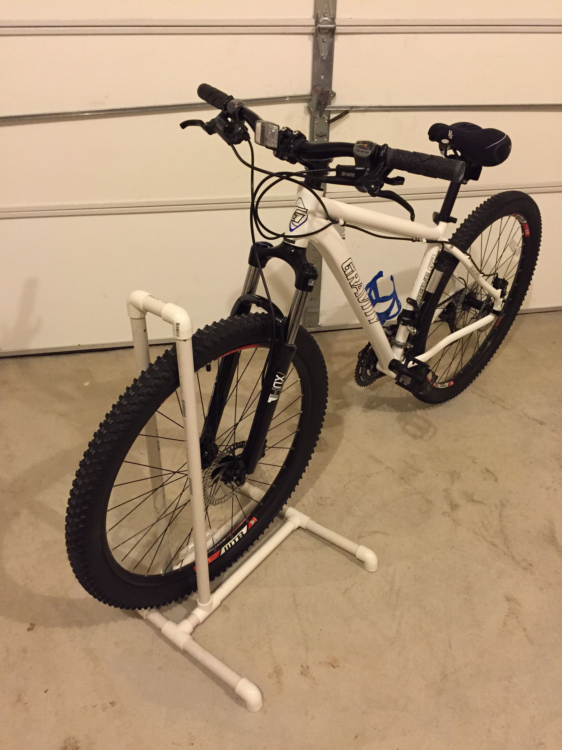

Thank you for the idea and instructions. Here is my version of the stand.

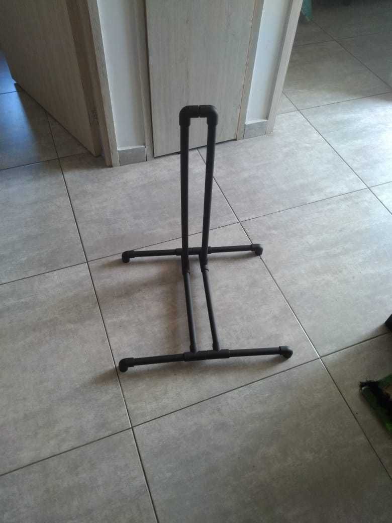

Thanks! I made it today! http://farm7.static.flickr.com/6130/5994418461_4764c25689_m_d.jpg
