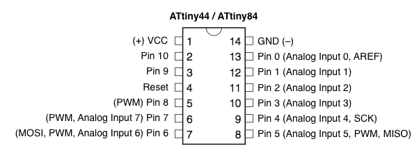

Step 3: Circuit: Attiny
The attiny84 is a board that works just like an Arduino but it has fewer pins and it costs WAY less. I will explain how you connect it right away but first you might want to see how to program it using an Arduino UNO as an ISP here (use 8MHz instead of 1MHz as shown in the tutorial). Solder the remaining socket for the attiny between the power supply and the 7447. The attiny is going to be installed face up too so the first of its pins are near the 7447s inputs. Connect the pins a,b,c and d (actual pins 7, 1, 2, 6) from the 7447 to digital pins 0,1,2 and 3 (actual pins 13, 12, 11 and 10) of the attiny and pins 1 and 14 output and ground of the regulator respectively. Next you need to connect the anode pins of the 7SD to the attiny as shown on the diagram. Connect the pins that correspond to anodes 1, 2 and 3 of the 7SD as shown on the diagram to digital pins 4, 5 and 6 of the attiny (actual pins 9, 8 and 7). Last thing for the display is to connect the dp pin of the 7SD to digital pin 7 of the attiny (actual pin 6).
