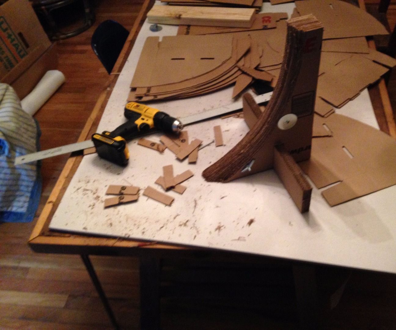

Step 2: Build Ramp
First, Screw 2" by 4" pieces in the bottom, top and front on one ramp side.
Second, Screw in the other ramp side
Third, Screw remaining 2" by 4" at regular 6"-8" intervals
Fourth, starting in the front, drill in the 1/4" plywood piece in the sides of the 2" by 4" pieces.
Fifth, work up to the top of the ramp, pressing the plywood to maintain its curvature
