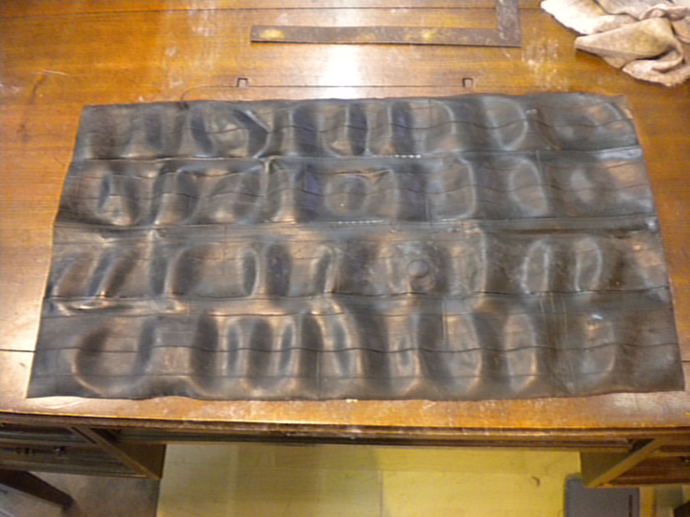

Step 1: Back Wall of Wallet
Back Wall of Wallet
1) Cut a bike tube to about 9 1/2" - 10" long. If the width is less than 4 1/2" - 5" wide (most are), you need to sew two tubes together and cut to 4 1/2" - 5".
2) Cut a vinyl square to about 9" x 4"
3) Hot glue/tack vinyl square to middle of tube sheet
4) Fold one long end of tube over one long end of the vinyl glue and sew fold.
