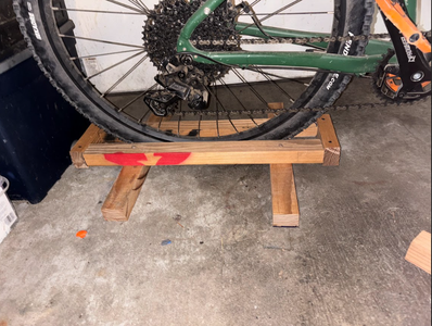

Step 2: The Supporting Piece
This part is compound of 2 pieces.

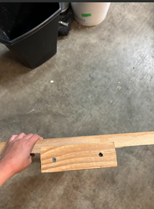

The lower one is just 2 pieces of treated channel and a piece of wood. It will support the bike.
Be careful to not take a too large piece of wood. You can see on my picture, mine is almost too large for my father's bike.
I really emphasis on the fact that you need to put something on the gross wood in order to protect your bike frame. You can go for foam of cork for example (my choice as I had some in stock).
The upper part is the trickiest one (but not very difficult ;) )
First you need to weld the bold on the sheet of steel. If you're a poor welder like me, I advise you to maintain the bold with the threated spindle, It will be easier to weld and you decrease the probability of damaging the threat of the bolt :)
Moreover, you should sand the bolt to make it easier to weld because mine was treated
Then you can assemble the second piece of wood with your steel sheet.
Finally, you drill the lower piece of treated channel in order to assemble the 2 parts.
I forgot to take pictures of this step but you can see the result on the last picture.
The two lower bolts are not tighten up, the plier is made by the upper piece

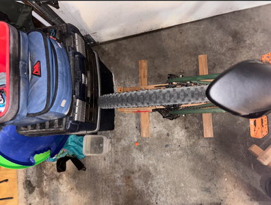

Step 3: Weld the Upper Triangle
As i said, the size of the horizontal axis (which will hold the bike) is quite long: 35cm so I decided to had a third piece to strengthen the thing.
The same thing has been done for the lower triangle (sorry again, no picture of this, IT issue :( )
Your bike stand is now finished, for a maximum of 30euros (if you don't have to buy tools) and made of steel so a long life expectancy !
