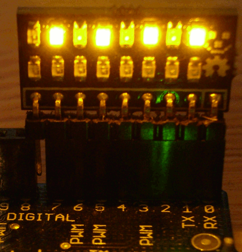

Step 1: Main Schematic
Really nothing special. If you know how to wire up an AVR chip on a breadboard or an Arduino on a breadboard, if you like that better, you won't have any problems with this one. I used KICAD for designing the schematic and the printed circuit boards. KICAD is open source and as opposed to eagle, which has a free (as in free of charge) version as well, there are absolutely no limitations in the size of boards you can make. You too get gerber files that work with any fab house you want. E.g. BatchPCB had no problems with them.
In the schematic you'll just find the cpu, the LEDs, a few resistors and capacitors. That's all. There's a few headers too. The boards have an ICSP header for flashing a bootloader and a 6pin header for convenient serial upload. The last 2 headers are mirrored and contain power, I2C and two more GPIO/ADC pins.
3 GPIO pins with 3 current limiting resistors are used to supply current to all 8 anodes of a single color. Individual LEDs are turned on or off using 8 GPIO pins to drive the cathodes. Depending on the type of operation the LEDs are either multiplexed (PWM for more colors) or fully on (higher brightness).
Some info on the packages I used for this board:
- ATmega168-20AU: TQFP32 SMD
- LED: PLCC6 5050 SMD
- Resistors: 0805 SMD
- Capacitors: 0805 SMD, 1206 SMD

In high brightness mode the board supports 6 different colors + white. The color is chosen by setting 3 GPIO pins to high or low. That way all eight LEDs can be fully on, but only show the same color.
In PWM mode the color is set by applying a pulse width modulated signal the the 3 GPIO pins and multiplexing the 8 LEDs. This reduces overall brightness, but now individual color control is possible. This is done in the background by an interrupt routine. Basic functions are available for setting the LEDs a certain color value, either using an RGB triplet or a HUE value.
The device is programmed in C using the Arduino IDE for convenience. I've attached the current code I use. Up to date versions are available on my blog. You can browse the GIT repository using the gitweb interface. Many stupid programming mistakes will show up, I'm sure of it ;-)
The second figure illustrates PWM generation. A hardware counter counts from BOTTOM to TOP. Once the counter is larger than a certain number representing a desired color, the output is toggled. Once the counter has reached its TOP value, everything is reset. The perceived brightness of the LED is somewhat proportional to the on-time of the signal. Strictly speaking that's a lie, but easier to understand.
