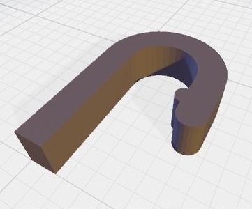

The bag is suspended from a bicycle's rear pannier rack by means of two clips. The upper, hook part needs to fit securely over the side rail of the rack while being removable without a struggle, while the lower part is a ring that slides onto a dowel running inside the top hem of the bag. I've attached the STL file I produced in Tinkercad but you're almost certainly going to have to design your own to suit your rack and dowel size. For some reason, I didn't save my final Tinkercad file, only an early version which has the hook part only:
https://www.tinkercad.com/things/3fbaGwb2hnd
But adding the ring at the base is a straightforward matter of adding a Tube shape and then Grouping it with the hook part. The little nub on the hook holds it securely in place on the pannier rail.

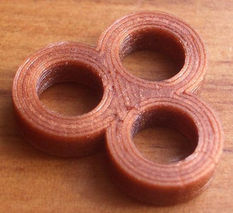

To get the ring part the right size, I printed a Grouping of three Tubes, each with a slightly different inside diameter, and chose the one that was loose enough to slide along my dowel/rod when pushed quite hard, but not so loose that it would slip on its own.
When you have a hook and a ring of the right size - you'll probably need to print a few, tweaking the dimensions each time, but the test prints don't have to be the full 10mm depth - combine them to make a complete hook and then print two. I used 20% infill because I didn't want to make the hook part too stiff and brittle in case it cracked when clipping it on and off the pannier rack.
