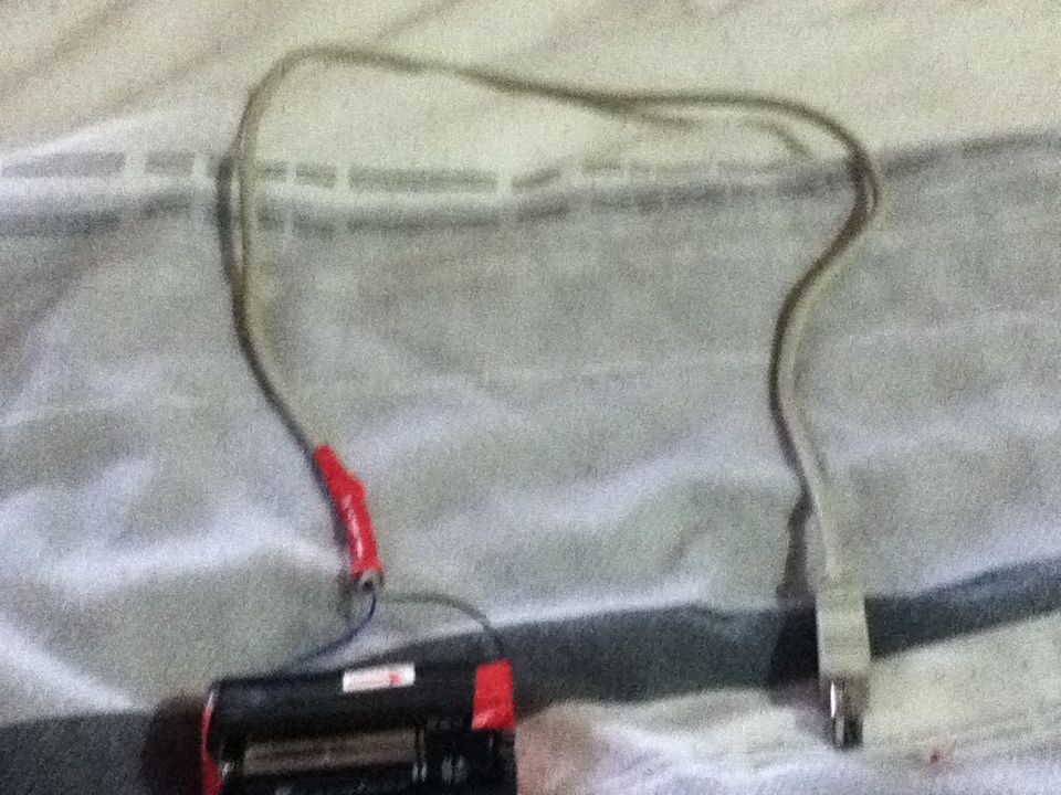

Step 4: Wires V2.0
Connect the fans wires to the lights wires and then to the striped end of the plugs wires.
Tape all the 3 wires on the left and then all tree on the right. Then only now can you taper them togeher.
