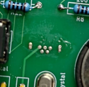

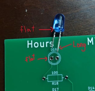

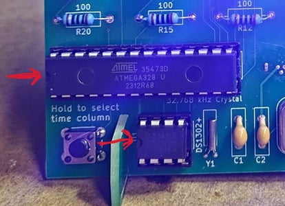

Insert parts into the printer circuit board matching these pictures. The only parts that need to be installed with a specific orientation are the LEDs and the two integrated circuits, (ATmega328 and DS1302+).
Solder all components from the back and clip excess wire flush.
TIP - When soldering the two integrated circuit sockets, I like to have the chips pre-installed in the sockets. The extra mass will help dissipate heat and possibly prevent melting of the sockets.
