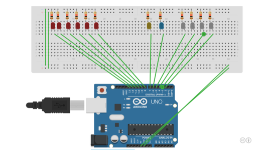

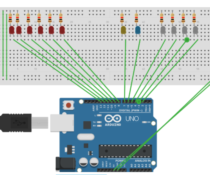

Step 3: Wire the Circuit With the Arduino
Follow the picture above to wire the circuit. It doesn't matter if you use a large or small breadboard to wire the circuit since the wires will be taken off and soldered later on. The short legs of the LED connect to the resistor and the long legs connect to the pin wires. The resistors are connected to GND (ground).
Step 4: Run the Code to Check the Circuit
Attach the 9V battery with the 9V battery cable. Plug it into Arduino. Run the code given to check the circuit is done correctly by using the USB 2 cable to connect the Arduino to your device. Open the Arduino app on your device to do this. Unplug the battery after finishing testing. You can either open the Arduino file or copy and paste the code from the PDF I provided. I programmed the code to also print the binary numbers on the serial monitor if you still have the Arduino and your device connected.

Step 6: Put LEDs in the Correct Holes in the Shell
Put the LEDs into the holes in the shell according to the pins and hot glue the LED. Pin 5-2 is the order it is already in for the hour holes. Pin 5 for the first hole and pin 2 for the last(fourth hole). The same thing goes for pins 8-13 for the minute holes. Pin 8 for the first hole and pin 13 for the last hole(sixth hole). You can switch the wires connected to pins 7 and 6 depending on if you want to start with AM or PM. The single strand of wire connected to all twelve wires that are connected to the resistors goes into GND. The ends of the wires that connect to the Arduino are male(can be plugged in).
