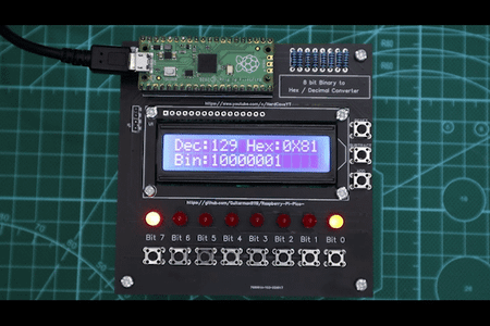

The learning board will convert an 8-bit binary number to Decimal or Hexadecimal.
The board has 11 inputs, which include 8 buttons to select from bit 0 - 7, an add, subtract and reset button. This will allow you set the bit high or low in an 8 bit number which will indicate through the LED - by turning LED on for 1 / High and off for a 0 / Low.
The Pico will take the 8 bit number and convert it into decimal and hexadecimal.
The 16x2 character LCD display will be used as output to indicate the results. The LED will display the decimal, hexadecimal and binary number.

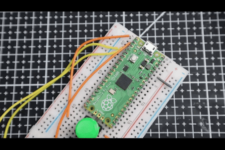

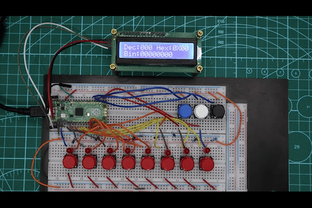

To following along with this project on the breadboard I have included the schematic diagram. One side of the buttons will connect to the 3.3V rail, and we will use an internal Pull-down resistors on the pins of the Pico. We will connect eight LEDs to the Pico setting the pins to output and using current limiting resistors.
The 16x2 I2C LCD will be connected to GP0 and 1 using the I2C0 communication protocol.

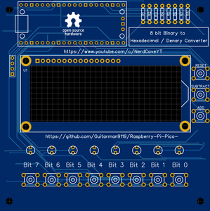

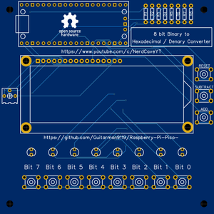

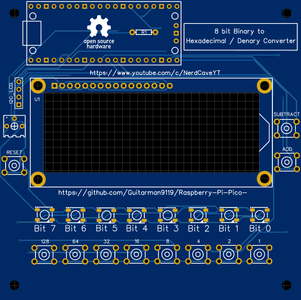

Step 2: PCB Design
I decided to make 3 separate PCB files. Which is available in the following GitHub repository.
  • PCB 1 - with I2C LCD support, 8 Through hole LEDs
  • PCB 2 - without I2C using 4 data pins, 8 Through hole LEDs
  • PCB 3 - with I2C LCD support and 4 data pins, WS2812b LEDs
