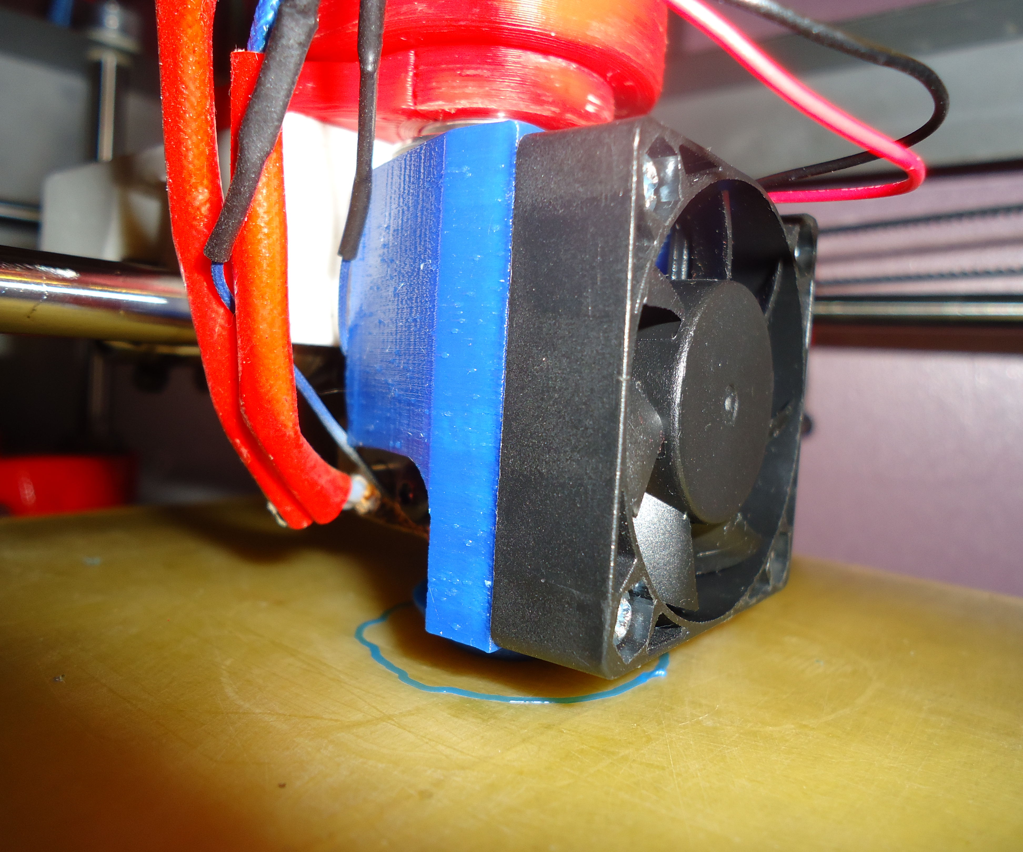

Step 1: Print All the Pieces
The files can also be found here: http://www.thingiverse.com/thing:499001
If you don't have a 3d printer you can get it printed at https://www.3dhubs.com/chicago/hubs/jonny
Settings: Use whatever settings you normally do, you can make the infill low since none of these are load bearing. The only part that will need support is the side_parts.stl
(quanity)partname
(1) main_body.stl
(1) top.stl
(2) side_parts.stl needs support material
(1) nut_holder.stl
(1) thumb_screw_top.stl
(1) ear_left.stl
(1) ear_right.stl
