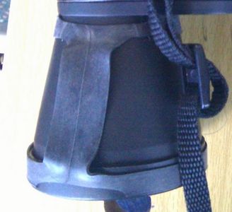

Carefully stretch the rubber over the end of the binoculars and the end cap.
