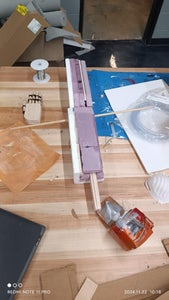

Step 2: The "Bone"

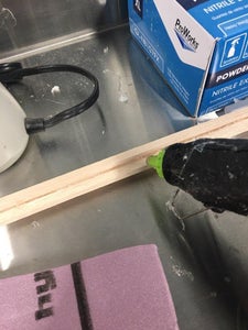

Glue 4 pieces of rectangular prism shaped wood together and one square shaped piece of wood in a big square. This will help start the foundation of the arm so it wouldn't snap in half easily. It is important that you pick and choose strong wood together with a tight seal so it can with stand a lot of pressure to make it hard to break and so when the person is wearing it , it wouldn't snap their arm in half causing a catastrophe in the project

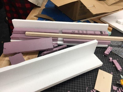

Step 3: The "Meat"

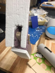

For the prosthetic "flesh" of our arm we used foam to cover the stick. You can use any material you see fit. We tested out cardboard, but we still stick with foam since it provided more durability and protection to the "bone" we made sheets of foam surrounding the main stick in a formation like so.

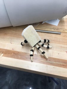

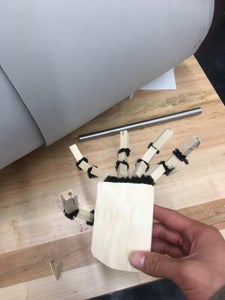

Step 4: The "Hand"

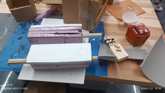

In my opinion this was the most fun part of the arm. First we measured my arm on paper and made a tick mark every flexion creases(Line on the finger) we saw. Then we measured the distance between each crease and marked them on a long piece of Balsa wood afterwards cut and trim a block of wood, or glue multiple pieces together. Drill 5 holes in the center of each block you cut out of the wood where you want to put the wire/ finger "bones" in. Then cut 5 pieces of wire, each a couple inches longer than the total length of all three finger parts to resemble a real life hand. Afterwards "thread" the pieces through and wrap some pipe cleaners around each join, adding from some cushioning and aesthetic design to the process to help prevent seeing the wire holding the finger together.

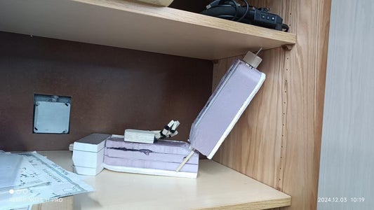

Step 5: The "elbow"
The Elbow of the design is quite simple.
All you need is a drill and drill bit that has the same circumference as the wooden dowel or any rod that you have.
Trim the rod and make an indent for the end/ stoppers if needed.
Drill a hole and then attach end/ stoppers to the endpoint of the dowels on each side.
You could also make some dents and make the stoppers flush with the arm.

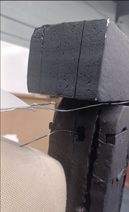

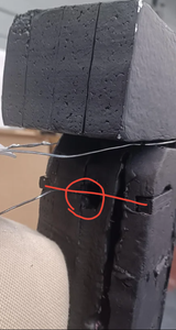

Step 8: The "shoulder"
You could add a block of foam for a shoulder pad, as it helps with covering the attaching of the arm.
But to attach the arm:
Drill a hole in the arm, the thickness of the wooden dowel
Then drill another hole perpendicular from the inside of the arm
Make a loop with the metal wire (don't cut the wire just yet, you still need to wrap it around the neck)
Put the looped wire into the 2nd perpendicular hole you made, aligning the loop to the other hole like shown in the diagram
Insert the dowel into the first hole, "threading" it into the loop midway through the hole, and out the other end.
Add stoppers on either side, and like before you can choose to make it flush to the arm.

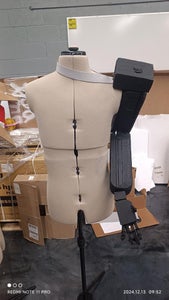

Step 9: Paint the "Arm"
paint the "arm"
Step 10: Attach the "arm"
Make wrap the other end of the looped wire and loop it around through inside and out the subject of the matter requiring an arm. Add a strap of whatever to cover the wire so it's not as noticeable. There you go! A really nice arm that 'can' move!
