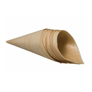

  • Bamboo cones (150mm)

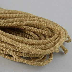

  • Hessian tube

Step 2: Making Paper Pulp Cones
  1. Place bamboo cones over a bottle to lift the cones up while you work
  2. Layer the pulp onto the bamboo cones with about 4mm-5mm thickness
  3. Take about 3mm from the tip of the cone
  4. Allow to dry for 48 hours
  5. Remove the cones

  1. Cut hessian tubes 5mm shorter than each power cable.
  2. Thread the power cable through the hessian tubing.
