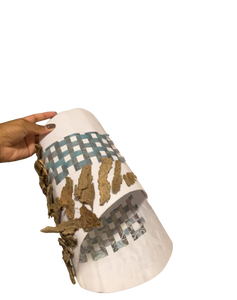

Introduction: Biodegradable Luminaire
Shown in the image is a biodegradable luminaire. The whole purpose is to be environmentally aware of what our products do to the environment once they're discarded. Usually our products such as lights, are not biodegradable and therefore they rather pollute the environment than have no effect. This bioluminaire is composed of materials such as bark, paper, biodegradable glue and biodegradable plastic, which will all break down if discarded. The light gives off a soft white light, suitable for ambient lighting.

Step 2: Paper Mache
To make paper mache:
  1. Mix 1:1 ratio water and glue in a bowl
  2. Cut strips of paper
  3. Dip paper strips into glue solution and paste onto mould, making sure that it is layered
  4. Allow to completely dry and peel off the mould
  5. Use glue to layer tree bark on dry paper mache
Step 3: Weaving
Weave bioplastic strips into paper mache, in any desired patterns.

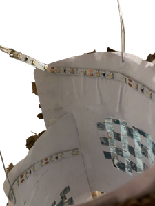

Step 4: Rolling
  1. Add a LED strip light at the top inner part of the material.
  2. Roll material and secure with double sided tape.
Step 5: Hanging
Hang to ceiling using strings of yarn all tied together on one end and connect LED strip to power source.
