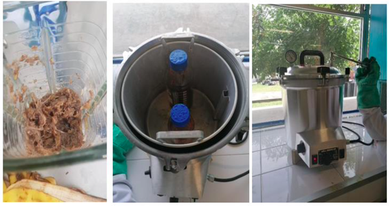

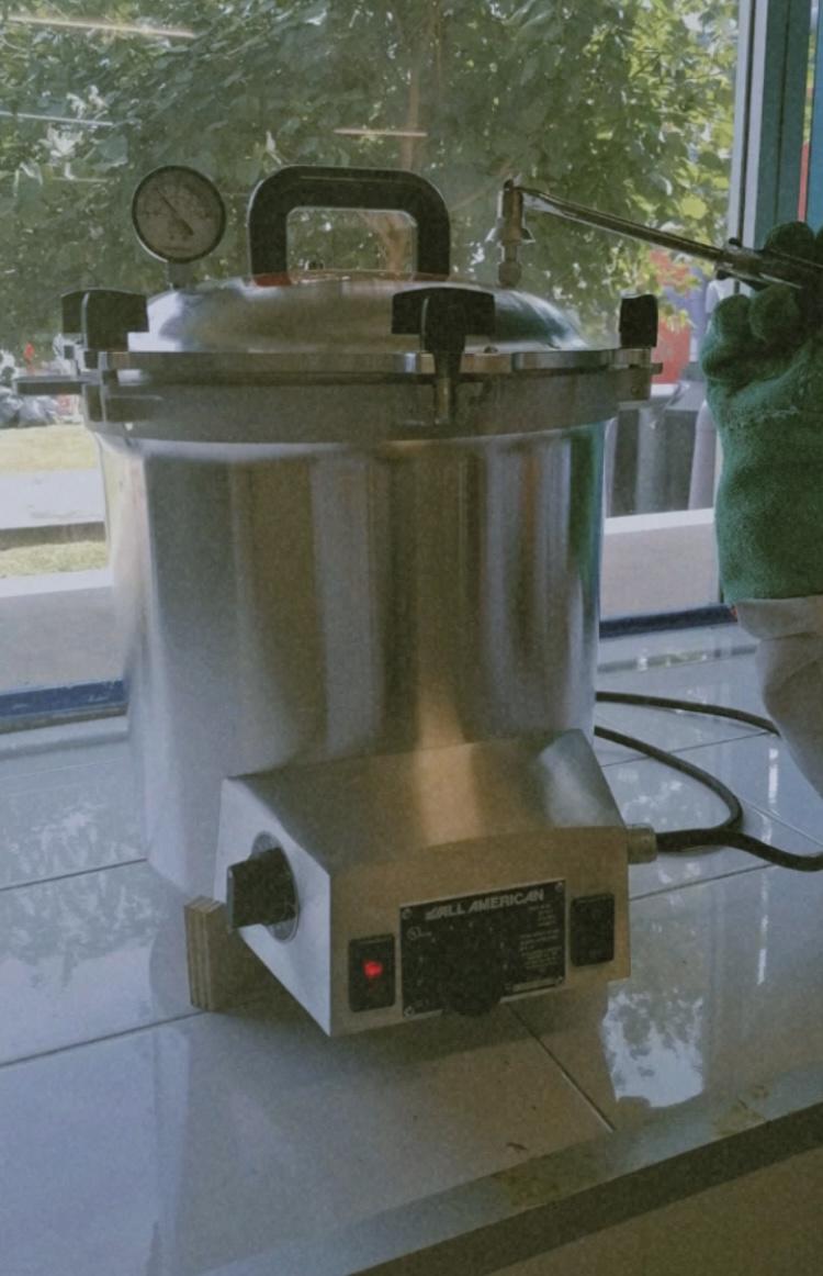

Wash and blend the banana peels until you get a paste. Place 250 mL of the macerated shells in the 500 mL autoclavable laboratory bottle. label the bottle: INOCULUM, place the rest of the paste in the other 1000 mL autoclavable laboratory bottle, label it as NO INOCULUM. Sterilize both vials at 115 to 120°C for ten minutes, cool to room temperature.
After the sterilization process is finished, the jars are carefully removed and one of them is meticulously placed in a bucket with cold water to avoid any accident; the reason why it is decided to use the bucket with cold water is to cool the jar with 250ml of mixture because it will be used as an inoculum object.

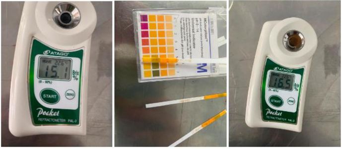

See the changes that are generated in color, in size, in pH and calculate its temperature in Brix degrees, this is done after a week and since everything is inside the 5-liter jug, monitoring any movement and waiting for it to produce ethanol, it is important to note that this is a homemade bioreactor and ethanol production is expected in a 15-day environment.

The crucial and most important moment for this bioreactor has arrived and that is to check if ethanol was generated. This is done as follows: 2 Fisher burners and the bioreactor in the middle are placed in a sterilized space, it is opened taking care of the presence of factors that may intervene and a small amount of the liquid produced is removed, poured with a strainer into a beaker and we put a lighter in the beaker, if combustion occurs that means that ethanol was produced, in our case there was ethanol production which leaves us with the conclusion that the bioreactor was successful.
