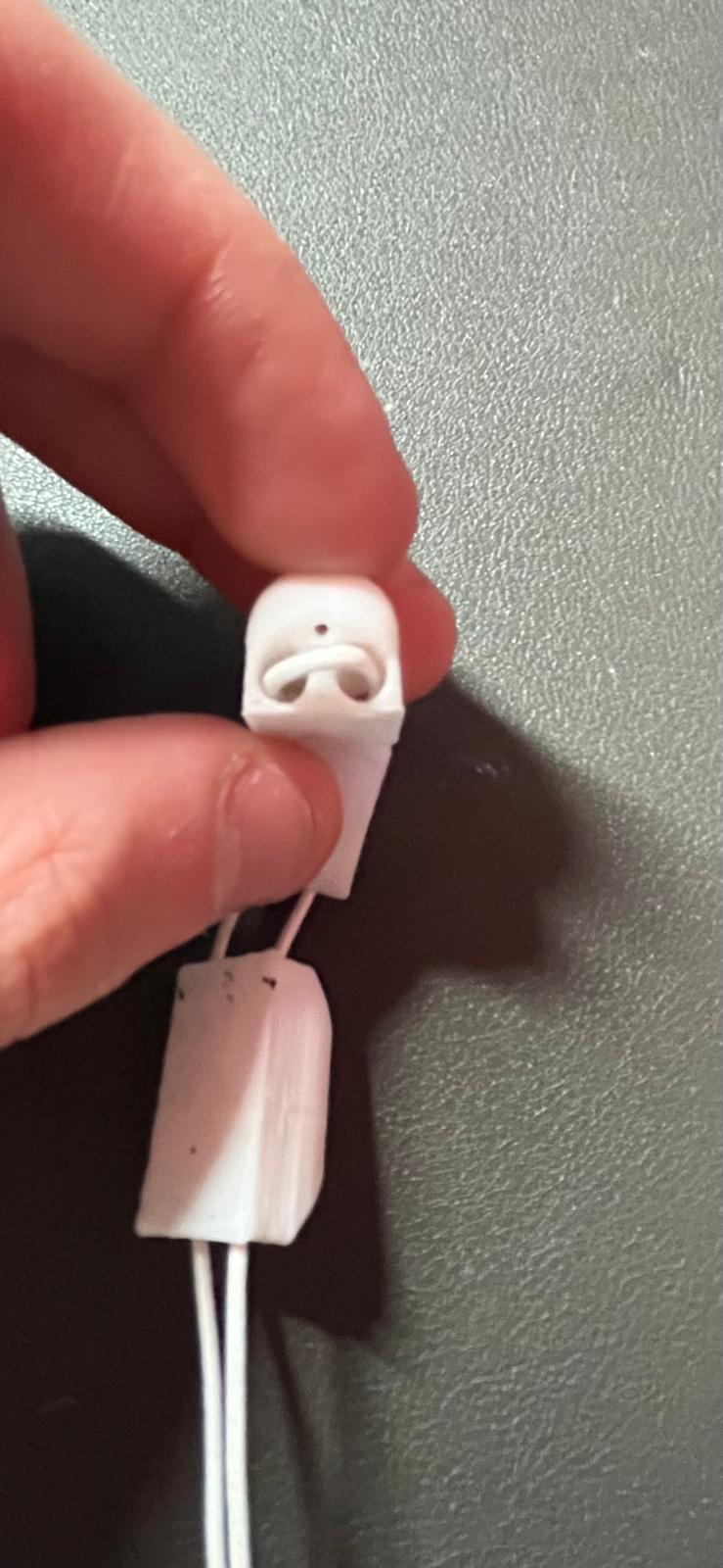

Step 3: Fingers
STRING ALL THE FINGERS INCLUDING THE THUMB. You need to have some sort of paracord, or a type of elastic stretchy string. This string will help the fingers return to their default position. If you do not have the string the fingers will be left down or in an awkward position but not upright.
  1. Cut a piece that's around double the length of each finger
  2. bend the string over and then feed it through the two holes at the top of each finger through the finger all the way into the hand
  3. once the string is poking out of the back of the hand you can make a double knot before cutting off the excess.
