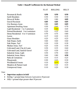

Step 2: Determine Land Cover and Runoff Coefficient
Use Table 1 to determine the pre-development runoff post-development and coefficients (a ratio of how much rainfall will be translated into stormwater runoff).
Example
For this example, the pre-development condition is Woodland & Forests (C = 0.15); the post-development is Light Residential (C = 0.4).

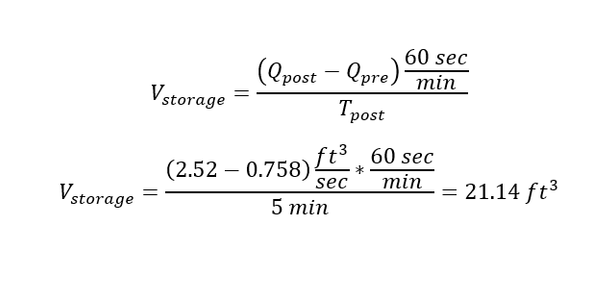

Step 5: Calculate Bioretention Cell Size
Calculate the bioretention cell volume using the following formula:
V = (Q-post - Q-pre)/T-post
In other words, to find the volume required, subtract the pre-development peak flow from the post-development peak flow found in Step 4, then divide that result by the post development duration used in Step 3 (5 minutes). As seen in the example above, you will need a conversion factor for the different units of time.
Example
In the example problem, the required storage volume was 21.14 cubic feet, which we will round to 22 cubic feet. This storage volume could be achieved by making a 4' wide by 4' long by 1.375' (or 1' 3/8") deep square basin. You can oversize the basin for more storage or round to whole numbers for easier construct-ability. Also feel free to try trapezoidal, circular, and other basin cross section styles for easier construct-ability and aesthetics.

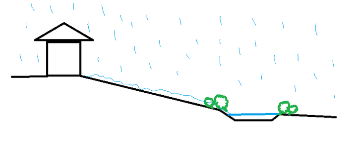

Step 6: Conclusion
A small basin such as the one in this example can be easily constructed by hand with a shovel. You will need to line the entire basin with small rocks or mulch to prevent erosion. Try to locate the basin at the lowest point on your property so all of the water flows to this point. Or you can put it next to your house and direct your gutter downspouts into the basin.
An overflow spillway will also be needed for when the basin is approaching a certain storage capacity (i.e. half or three quarters full). The spillway is simple cut or hole in the downstream side wall of the basin where water can flow out of when the basin is at a certain capacity. For a basin of this size, a 0.5' high by 1' wide rectangular spillway should be sufficient: be sure to line the spillway with rocks or mulch as well.
