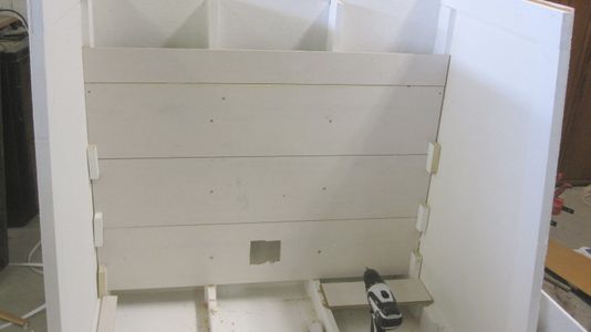

The back was made by gluing 4 vertical strips to the Pergo flooring pieces. Once the glue had dried I glued and screwed a piece of hardboard to the back.

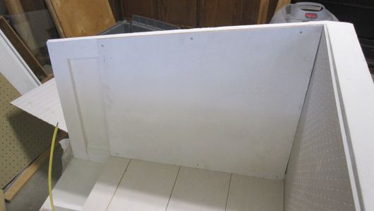

Strips were temporarily clamped into place to get the actual sizes for the pieces that would make the sides. The front is to be angled 10 degrees from the vertical. I then cut two identical sets of strips for the two sides and glued and screwed to the existing wooden pieces.
I then cut two panels from scrap hardboard and glued these to the outside of the strips creating two sides for the cabinets.

The cabinet was beginning to take shape. For the inside back panel I decided to go with the very stiff Pergo flooring panels that I had got from a freecycler. I cut these to size and then test fit them in the back.

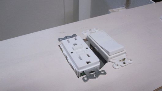

To the bottom most panel I added a slot for an AC GFC socket (bought new) and a power switch for the socket. The power switch and the plastic panel that would cover the opening were also from a freecycler. This AC socket would provide power for stuff like Pipet Aids etc to be used inside the tissue culture hood.
Step 6: Inside Back Panel With Wired Socket and Side Panels for the Cabinet
I wired the socket as shown. Solid mains wiring was used. The bare copper wire went to the 'Earth' hole in the AC socket and then wrapped around the earth screw on the switch. The black Live wire went to one end of the switch. A black wire connected the output of the switch to the AC socket. The white wire (Neutral) went directly to the AC socket.
The socket was attached to the back panel with a foam insert to prevent air leaking through the whole socket assembly.
The back panels were fitted into the cabinet, followed by a test fit of the bottom perforated panel. The bottom panel is a polypropylene peg board that I bought online. Two inside side panels were cut to measure and attached to the side wooden strips.

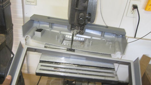

I had a room air purifier from RabbitAir that we had not used for the last three plus years so though I would recycle this for the tissue culture hood. The unit has a four stage air purification - a prefilter to hold back hair and lint, the HEPA filter that would hold back 99.97% of particles of 0.3um size or larger, an activated carbon filter and finally an air ionizer. More importantly replacement filters are available easily and at much lower cost (about $50) than filters for commercial tissue culture hoods which cost about $500 or more.
The 3rd figure shows the general assembly of this HEPA set up. I am planning on adding a lot more detail on taking apart the air purifier in a youtube video.
The back of the air purifier is the shroud for the blower. This back was attached by screws to a piece of hardboard. Air from the outlet would be directed by a deflector made of triangular pieces of plywood and a cover to form the duct. Images show the steps to create this duct.

The blower motor unit and the associated circuit boards fit into the gray base. The frame that hold the filter was trimmed of extra plastic and then attached to the base with the original screws. The filters were then placed inside the frame.
